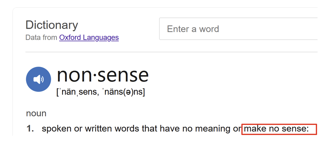

I think you will find I said it was nonsense; that is not the same.
That doesn't make me wrong. Is your voice like Starmer's?
Wrong about what?
Wrong about the rule not making sense? No.
Wrong about banging on and on and on about it not making sense when that lack of sense is of no relevance whatsoever to the existence of the rule, to the enshrining of the rule in the wiring regulations, and to the fact that breaking the rule creates a contravention of the wiring regulations? Yes.

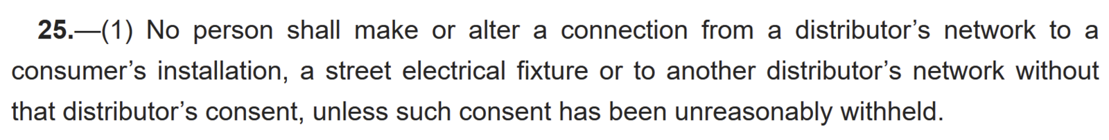

Wrong about it being OK for you to remove their fuse and replace it with one of yours? Yes - that would be altering the connection.
Again - I didn't know, so I did some research, and was led to The Electricity Safety, Quality and Continuity Regulations 2002
Can't see how removing their fuse and replacing it with a different one is not an alteration.
Removing then fuse then later replacing the same one so as to be able to change a CU is one thing. Swapping the fuse for a different one is quite another.
