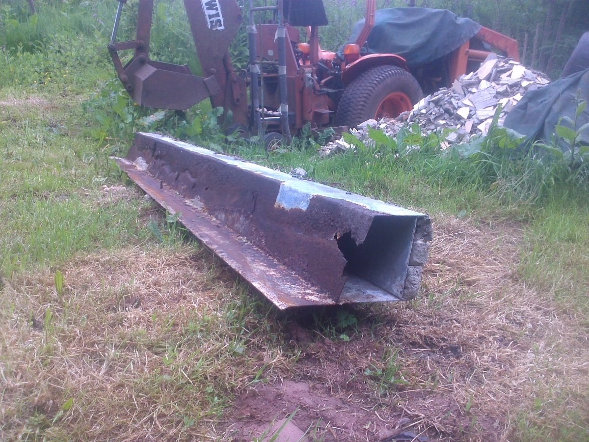

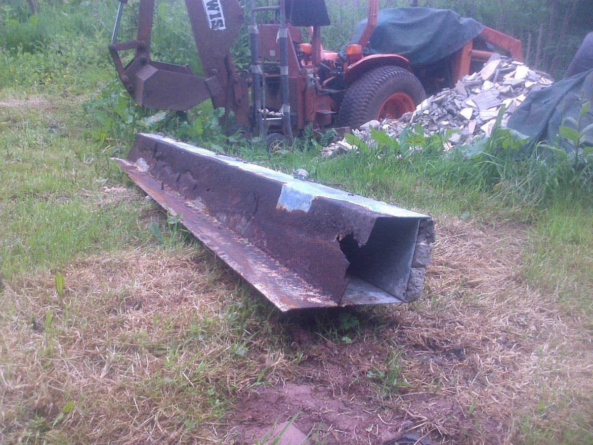

Catnic make lintels, proper lintels. Proper lintels are coated to stop them rusting and expanding.
Not always woody, this is one I removed last week which was from a mid 70's build
litl
