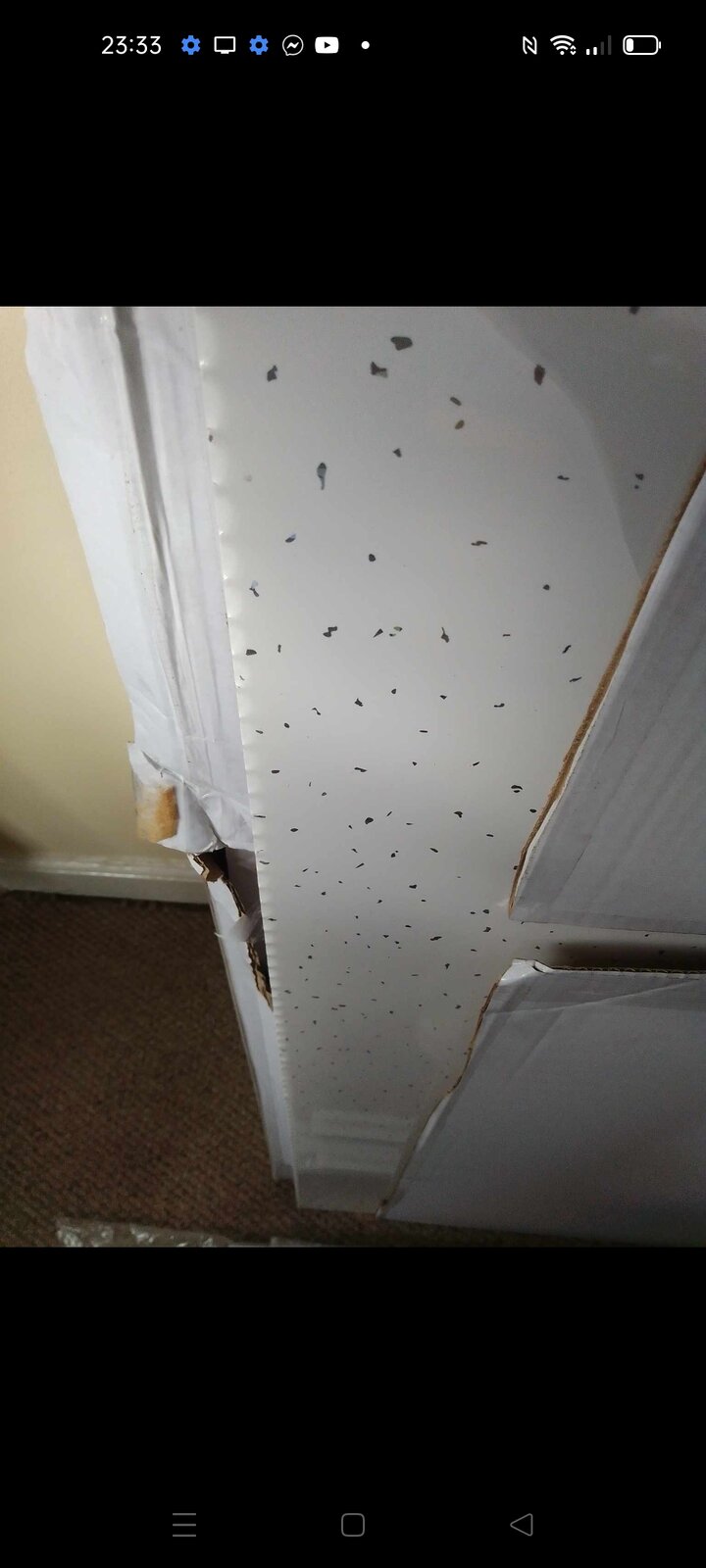

The ends look like this on both sides. Would probably have to cut the bottom of it off to get a decent edge to fit in the bath.

Ah, that's the cheap nasty hollow core stuff isn't it? There should be some end cap profiles available for it. The panelling made from plywood or solid laminate is much better quality though

Looks like aquapanel brand. Normally it's 2.4 mtr long to allow trim down to 2.3.
You can get a good cut with a decent circular saw and masking tape. Would normally scribe into the bath edge and silicon and scribe ceiling and silicon that as well. Use the corner profiles for corner and end profiles if needed.

That's Honeycomb wet wall that hasn't been stored properly, the edges have been compressed, showing the internal webbing.

All the shower boards I've bought have been the same at the ends, I suspect it's to do with how there clamped for the saw to cut at the factory.
Either way the instructions normally say both ends will need trimming before fitting.
Strange, all the board I've worked with and the joiners I've worked with get don't have any of that marking on them. Most if it comes boxed up with edge supports and comes out without any of that on it at all.
Doesn't solve the problem though, OP, the guys I know that work with it all the time use a jiggy with a new fine cutting blade and support the cutting edge well.

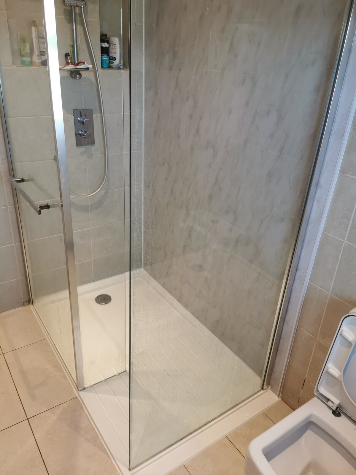

I fitted some hollow panels in our en-suite corner shower. From Celplas.
I think I had the tidy the ends up. Masking tape (black panel) and a standard hand saw.
End caps for the sides

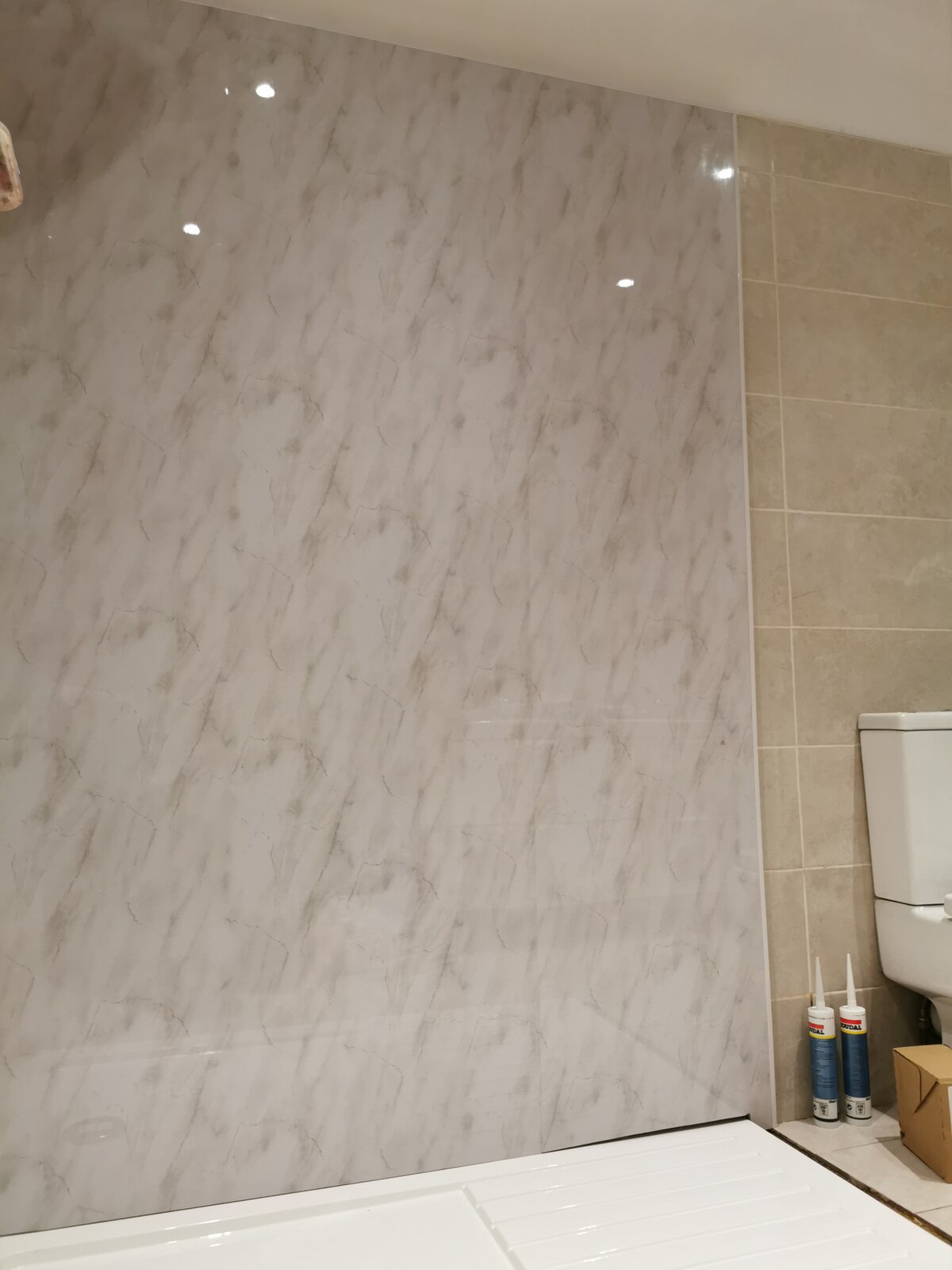

Used the same type of seal Foxhole linked on the top of the tray.
Silicon joint from top to ceiling to tidy
Look fine. You can see the underlying structure when the sun shines on them. Maybe that is due to the colour.
No more grout to scrub :)
