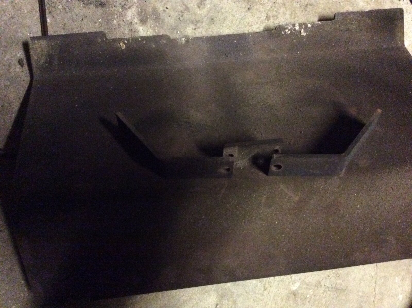

First thing to establish is, is the register plate fitted correctly, has anything fallen down and are there any restrictions in the flue or cowl too close at the terminal ..any bird guard thats clogged got a pic of stove and flue pipe
Thanks, there are no blockages, no issues with the chimney, etc. I believe it to be an issue with the stove as the baffle is too restrictive to allow the smoke to escape upwards especially when there is a bigger opening, in my case the door. I was hoping that there might have been Arada owners or installers who are experiencing and solved the same problem.
9F14608D-F689-4BC2-B688-18E28C4ACE20.jpeg Sorry, It was the baffle I meant not the register plate, Some stoves I guess to improve efficiency have wings on top of the baffle plate that can be removed if smoke comes through the door, is there anything like that on yours
Sport nothing like that only a very small gap for the smoke to have to pass through
