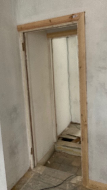

I've attached a photo one that ive done so far. It's a bit blurry but hopefully you get the gist of it. It probably would have been better if id chose a thinner architrave as i think it's quite noticeably missing one side as it stands...

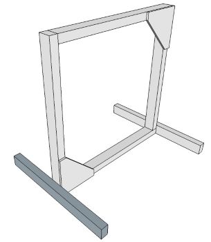

If you are working on doors you'll probably need a couple of trestles. The traditional joiner's trestles are nice to own, but maybe a tad complex for a beginner, but a pair of site trestles can be knocked-up quickly from 3 x 2 softwood and look like this:
