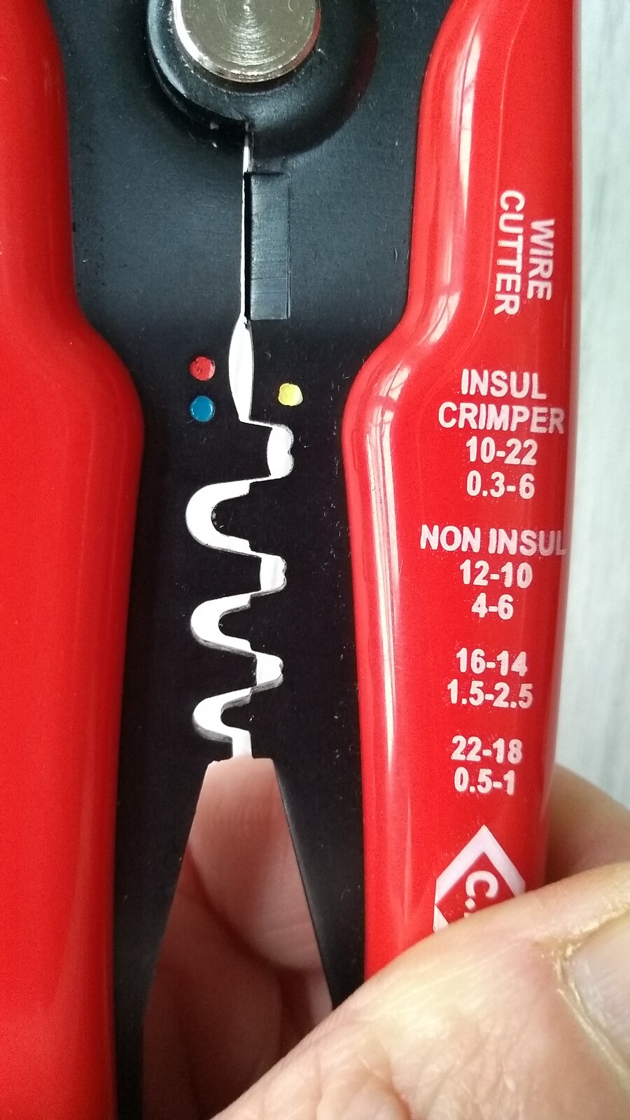

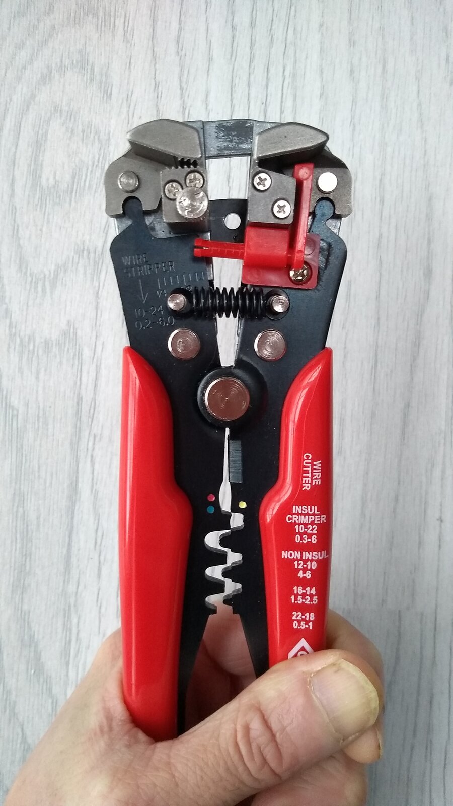

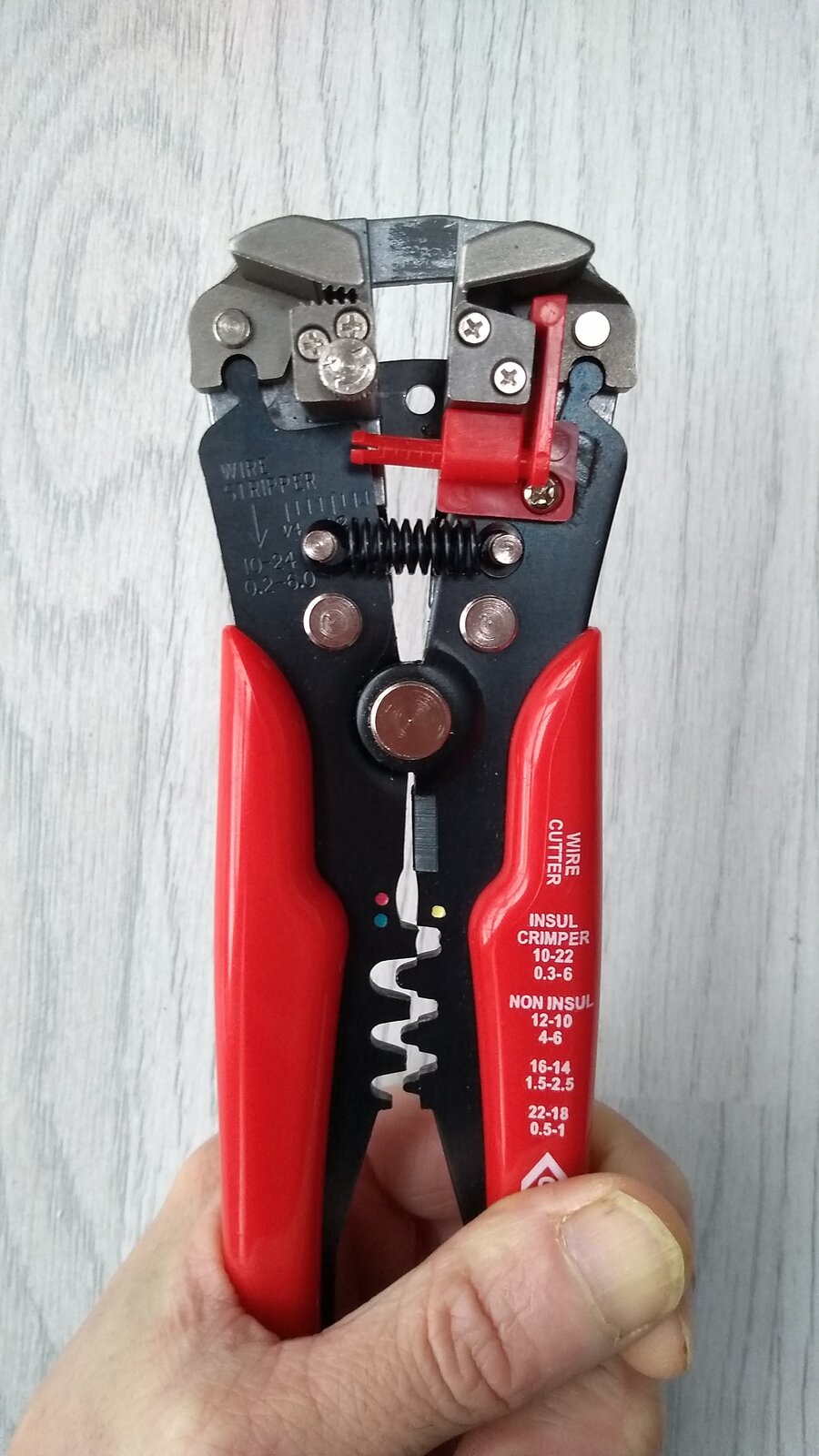

I do have a crimper although not a double one to do both tags at the same time, its within a CK auto wir stripper.

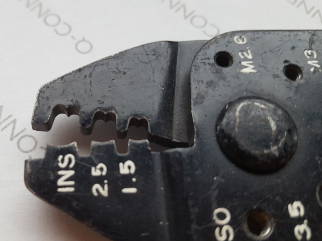

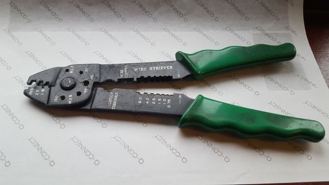

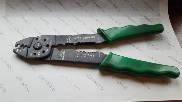

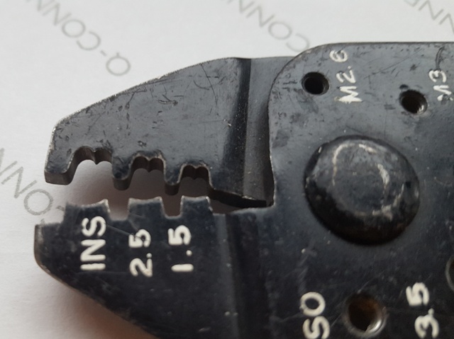

I dont see any problem cutting off the piggy back spade. These are the RS crimps meant to be used for that style of connector20211220_085510.jpg 20211220_085523.jpg as you can see the crimping bit is designed to curve and fold the wings round the cable.

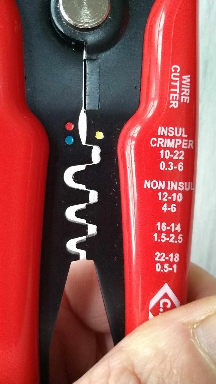

you dont have to do both tags at the same time, just do the cable crimp then do the sleeve crimp (its what I do !)

I figured that I didn't need to do both tags at the same time but when you say you do cable then sleeve, which is which ? is the cable one the narrower one that nips the insulation. My strippers with non insulated crimp are about as thick as the narrow tag, so the wider one I will do in sections IMG_20211220_133703847.jpg IMG_20211220_133715555.jpg
The wire is the 'cable'.
The sleeve is the covering/insulation.
Crimpers are the right kind.
Ok got you. Was confused as I thought "sleeve" was perhaps referring to the wider tabs on the connector.
