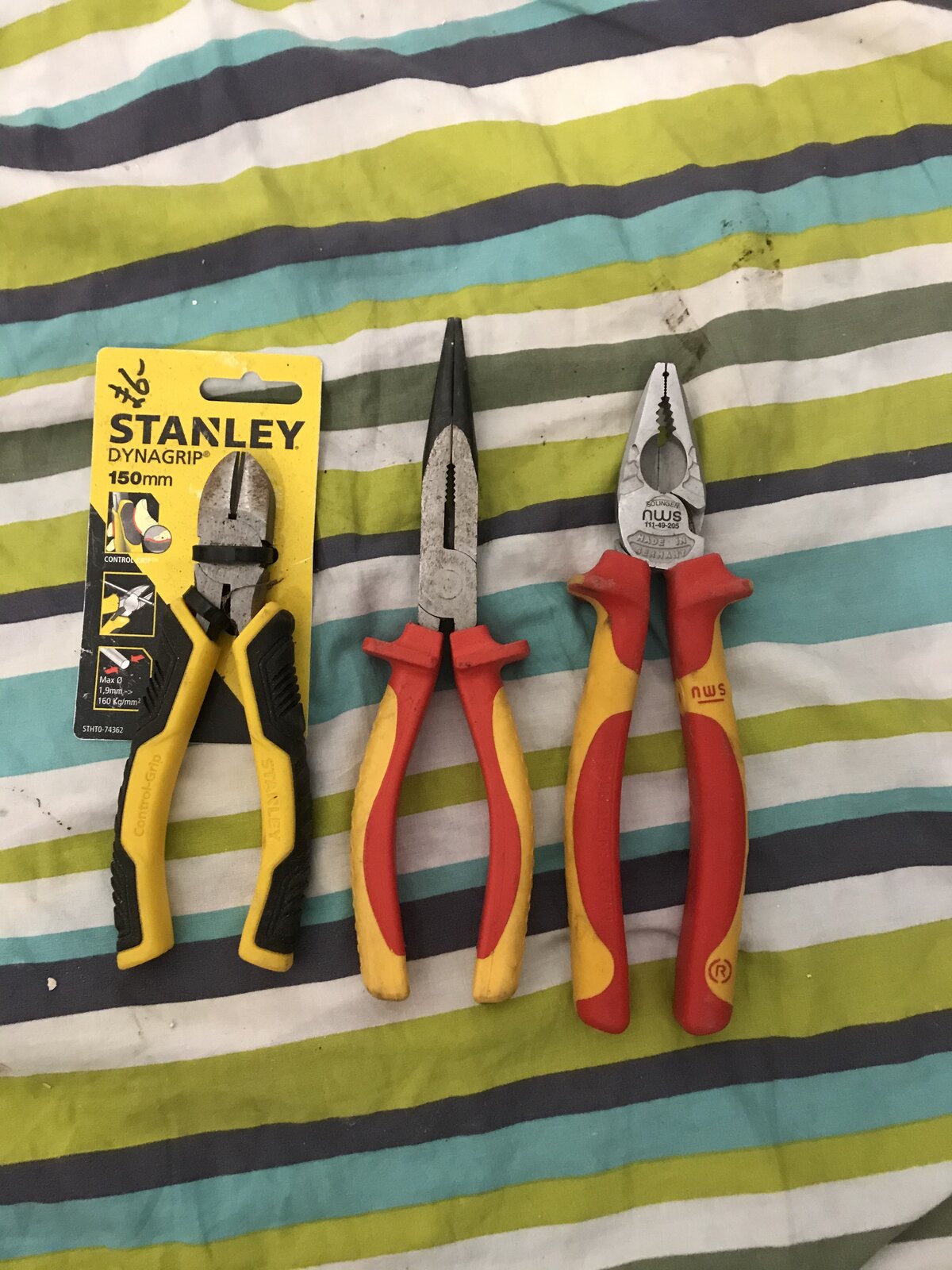

I think the term is VDE but are any of these safe to use on electrics? I’ve got the proper screwdrivers but unsure on the cutters.
Thanks in advance.

They would be safe if the circuit you are working on is not powered up.
If the power is ON then accidentally touching the metal part of the tools could give a fatal electric shock.
Cutting a cable that is carrying current has risks of arcing.

VDE is a German approvals body who approve many different things to many different standards. They seem to have become the go-to certification body for insulated tools, perhaps because many of the quality tool brands are German. There is no reason other certification bodies could not also certify stuff to the appropriate standards though, nor any reason a trusted manufacturer cannot self-certify.
Looking at your picture, the item on the left is certainly not an approved insulated tool. The two on the right look like they probably are, but one can't be certain from a picture alone.

The purpose of my post was not to equip myself to knowingly start working on Live circuits but as you put it above, to ensure I have some added protection. I always use my Fluke two pole tester for checking that circuits are dead before making any changes but would still want the comfort of knowing I am using a tool which provides protection in the event of any unanticipated current. I think this is where I need to have a VDE pliers (I appreciate that there are other bodies too). I have discounted the Stanley cutter. The other two pliers in my picture state "VDE 1000W" I have just spotted.

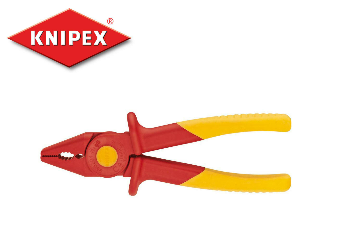

You could get a pair of plastic pliers if you’re really worried
I've had a few like that over the years, and maybe they've improved since then, but most of them I'm had have lasted until I've first tried to use them, at which point something has 'snapped off' :)
