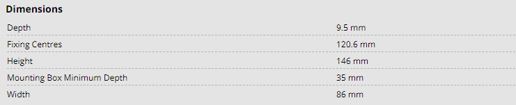

Hi. The patress for the shower switch was smashed, but the switch plate itself is OK. The switch itself in made by Scolmore, Click brand I think. SW34511D-14B.E. But the patress is made by Legrand. 7364 11 15W50. So, the switch has an aspect ratio of roughly 2:1. (145mm x 85mm). Basically, I'm assuming there will be no problem going to say Wickes and finding a suitable patress, because there is a standard regarding fixing holes. Is this correct? Thanks. P.S. Interestingly, when you buy the Scolmore switch, you only get the switch,, with no patress if I am correct on this. Which perhaps tells you something. Which wou;ld be I suppose, that the expectation is that buying a matching patress is easy peasy.

These are the sizes for your switch according to:

There is no industry standard for fixing hole positions in pattress boxes.
To be clear.
* The holes used to fix the accessory to the box are standardised, at least for regular "single" and "double" boxes.
* The holes used to fix the box to the wall are not standardised, though you may get lucky.
* The overall size of the box is standardised, but the precise shape of the corners does vary slightly, so some boxes look neater with some accessories than others.
If you are bothered about re-using the old fixing holes, and can't get a pattress that has the fixing holes in the same place, consider buying a PVC 47mm pattress, and drill your own holes.

Hi. I went to B&Q (first shop I went to) and bought a deep pattress that fits the switch faceplate. The faceplate is exactly as wide as the pattress, but is 1mm or less short in the length at either side, but there is no daylight between the pattress and the switch plate. So, I'm figuring to use the pattress. And perhaps just smear on some putty or similar on each lengthwise end.
