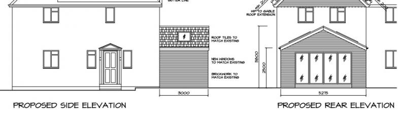

We've recently had a single story rear extension built on our house. It has a pitched roof, with bi-folding doors in the wall under the gable end. The doors are 3600mm wide, the whole extension is 5500 wide.
There are no joists resting on the wall above the doors - do we need to provide structural calculations for it? As far as I'm aware the builder used a lintel and not a steel beam as there is no load on the wall - does that sound like a breach of buildings regs?

The joists for the pitched roof are on the side walls of the extension, not above the patio door. There are just a few courses of bricks/blocks forming the gable end above the doors. Image (hopefully) attached.

Looking at the rear elevation, the lintel is supporting the triangular gable wall above.
Building Control will ask for justification of the lintel in that case.

There was no lintel specified on the drawings submitted. I guess I'll have to speak to the planning officer and find out if he inspected the lintel at the time. if not I guess I'll have to pay someone to expose it and tell me what it is.
Jeez, so they gave you a Full Plans Approval for the Building Regs drawings that were submitted before works commenced on site and the fact that your drawings didn't specify a lintel didn't raise an eyebrow, I would be considering speaking with the Head of Building Control, because some heads need bashing together!
Just for clarity, you're not confusing your Planning Application and a Building Regulations Plan Application?
I was thinking that. The example posted above is a very basic plan for Building Regs. and to get full plans approval without specifying the lintel? Most irregular.
