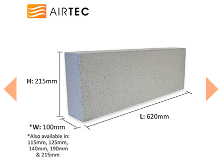

Took all the advice and searched online for a solution and got one that the building inspector has approved at 280mm thickness:
https://www.multifoilsdirect.co.uk/solutions/superquilt-external-wall-ybs-superquilt/
Wall includes:
- external render
- insulated plasterboard
- 25mm batten
- 7mm SuperQuilt insulation
- 25mm batten
- 190mm AirTec Standard block
(In case it helps anyone in similar situation), exterior wall needed to satisfy two main conditions in the new regulations:
Part A: solid wall must be at minimum 190mm thick (page 16)
Part L: wall must be 0.18 u-value or lower (table 4.2, page 25)
My challenge now is finding somewhere that supplies 190mm Concrete Aerated Blocks (3.6N/mm2) in London - so far, no luck. Or I could double-up blocks/bricks that total 190mm but that's tricky too.
If anyone knows where I can find 190mm blocks like this then please let me know. Thanks again.
