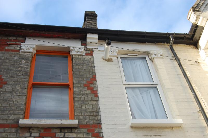

Anyway, here's some photos of the offending flue:
I would at least AR that without getting my tools out or going in, and could probably make a good case for ID.
Any chance you can post a pic taken a little bit further away from the wall, and in portrait rather than in landscape?
Just curious to see if I can spot an even half dozen fails. :roll:
Its a baxi boiler and baxi tech department say standard flue can be left to stick out that distrance without being detremental to operation of boiler due to cooling.
I would say he has left it sticking that far out to get away from the window as oppossed to the eaves as the measurement for that is only 25mm for the majority of baxi flues
It is too close to openable window it does not look 300mm from centre line of the properties, the flue looks to be on its side.
It needs a proper plume kit on it to take it up and over the eaves

Here are a couple of side views, in portrait:

AR = at risk, bad enough to warrant compulsory remedial work
ID = immediately dangerous, so bad that it is compulsory disconnection until repaired.
The portrait picture I mentioned is fine to upload horizontally, I just meant take it from a bit more distance holding your camera so that the photo is higher than wide, and full size/high res, would not go amiss either.
There is no outlet visible for the safety valve. If that is wrong, anyone near the boiler can get sprayed with steam between 110C and 120C; if that hits you in the face, you end up looking like Niki Lauda.
A phone call to corgi with the message that you have serious concerns about safety would be a good idea.
tell them about "no pressure relieve valve visible" and "fumes getting indoors" should get an inspector out on the double.
There is no cost to this and no blame if it turns out to be false alarm.
