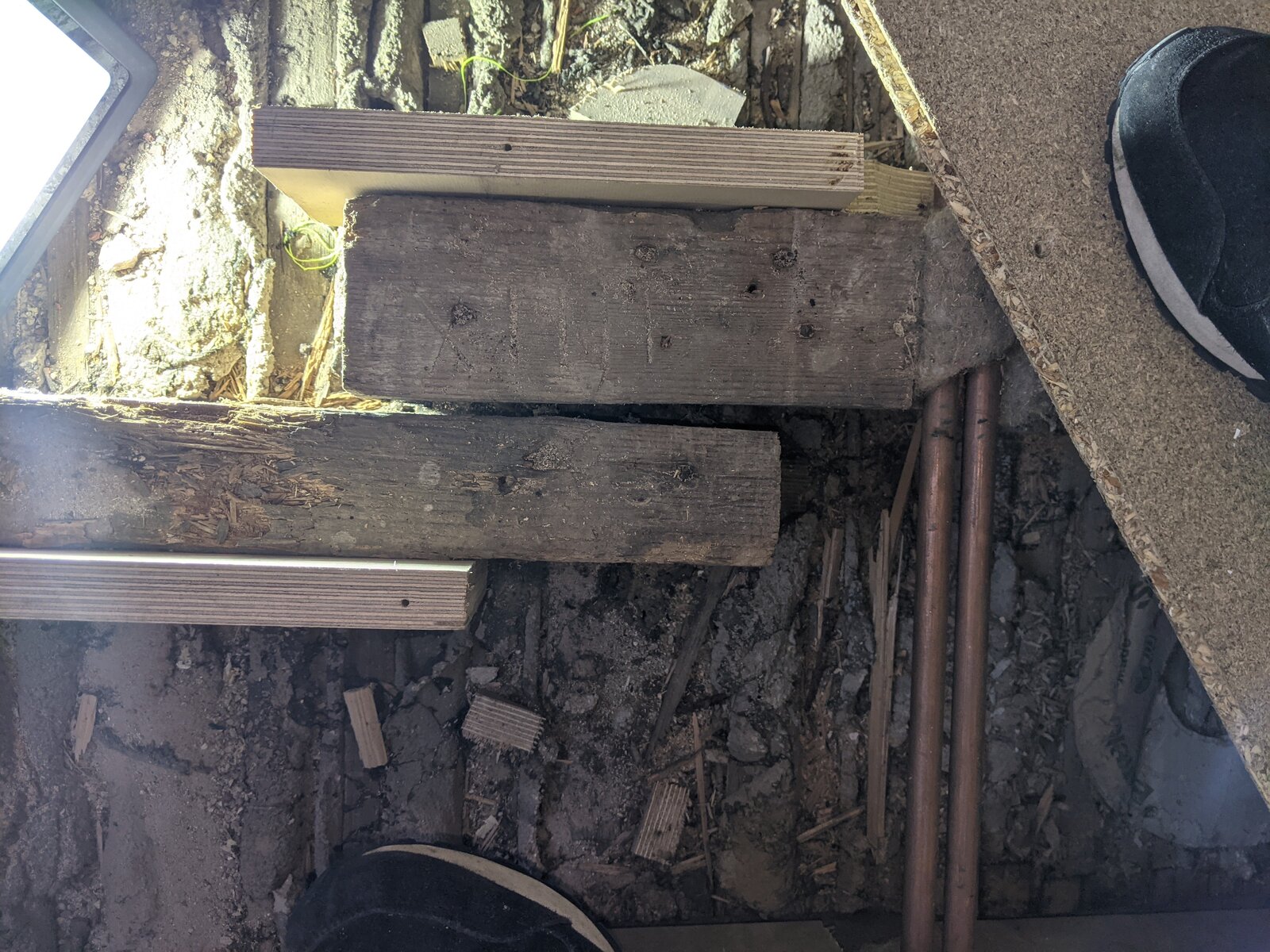

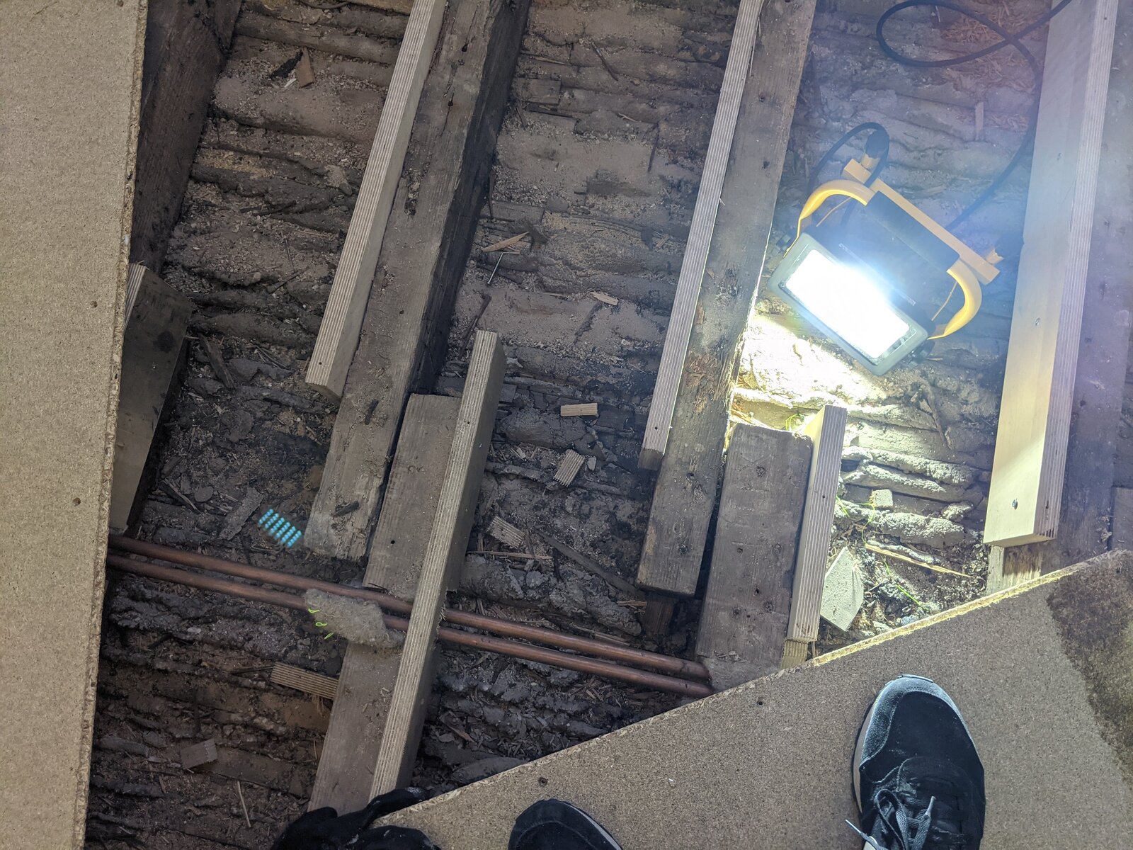

Are these joists supported correctly?
You cant quite see in the pictures but underneath where the two joists overlap is another joist going in the horizontal direction (direction of pipes) and the cut ends rest on it
Hard to tell without details of the beam underneath, but given the depth of those leveling strips then possibly not.

the beam underneath is a wood beam - situated between two brick walls. by the looks of it the house was extended and this is the result

What's the ply doing? Raising the floor?
Where is this? A loft? Looks like then underside of a lath and plaster ceiling?

To be honest; it feels quite solid. Any suggestions on a DIY fix? or does it need a major change?
by the way i'm not so sure now that the house was extended. Do you think it could have originally been built like that in 1900?!?

The main issue is the plumber cutting into the joists. I presume this was to allow a floor to be laid over. Did you take a floor up?
I wouldn't do much with it other than maybe add a few more lengths of ply similar to what's been done. And maybe add a few more fixings to the existing ply.
It's been like it for yonks and if it seems solid I doubt it will cause a major issue.
no ideas who the builders
Seen as I've got the floorboards up will sure it up. Maybe use joist fixings to clamp both hosts together
