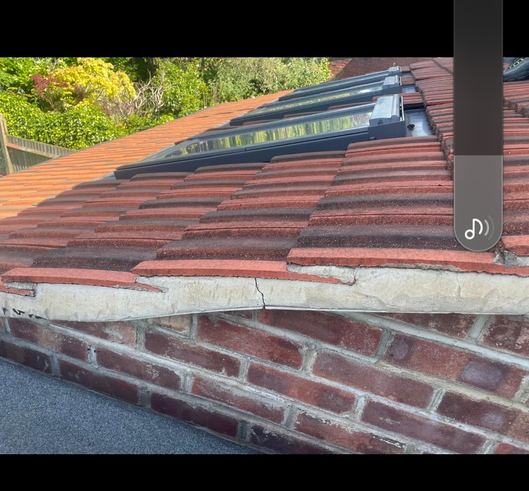

Are these redland 49 tiles?
17 Jun 2024
7

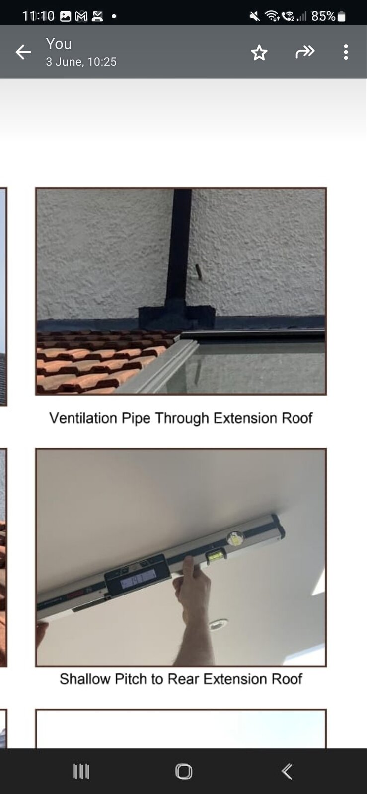

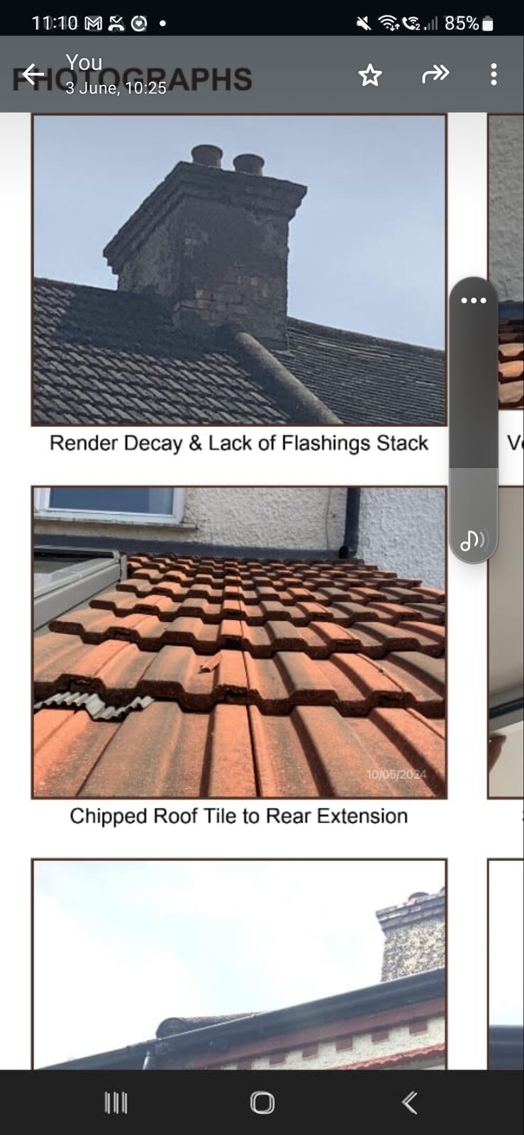

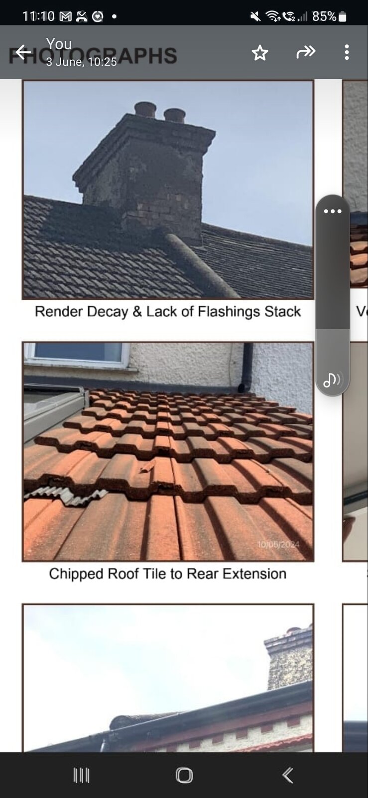

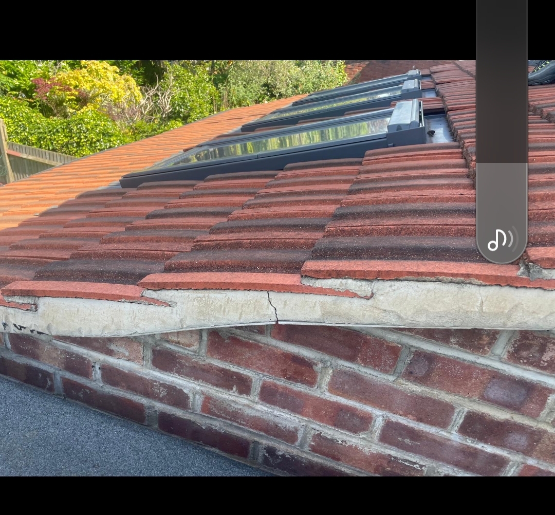

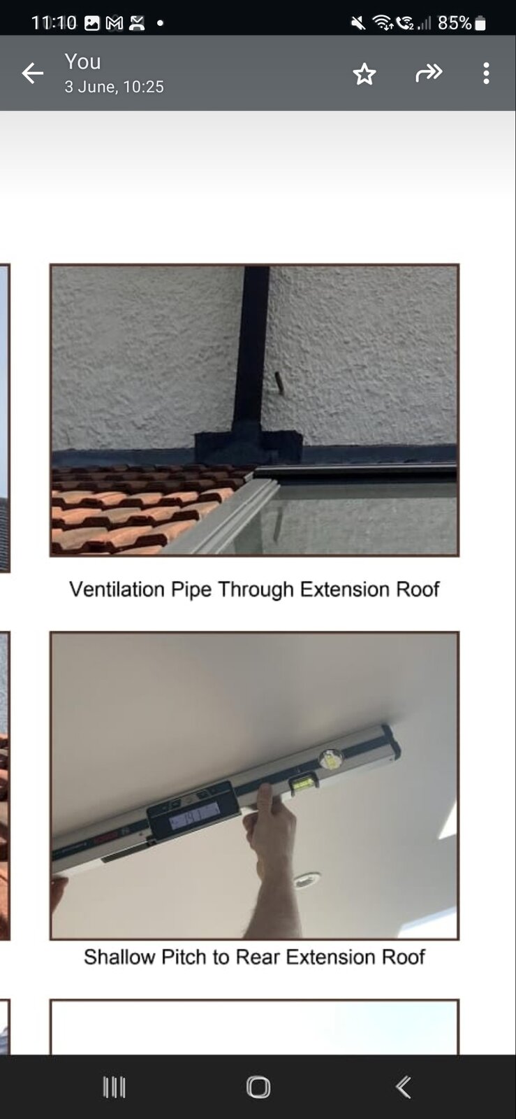

Are there redland 49 tiles? I had a survey of an extension roof and he thought they were and that the wrong tile had been used for the pitch of the roof (approx 19 degrees). Do you agree?

Yes head lap is very important .
Firstly yes you have Redland 49s in smooth .
Secondly you have short headlap.
If you have a problem , Redland won't pick up the bill
