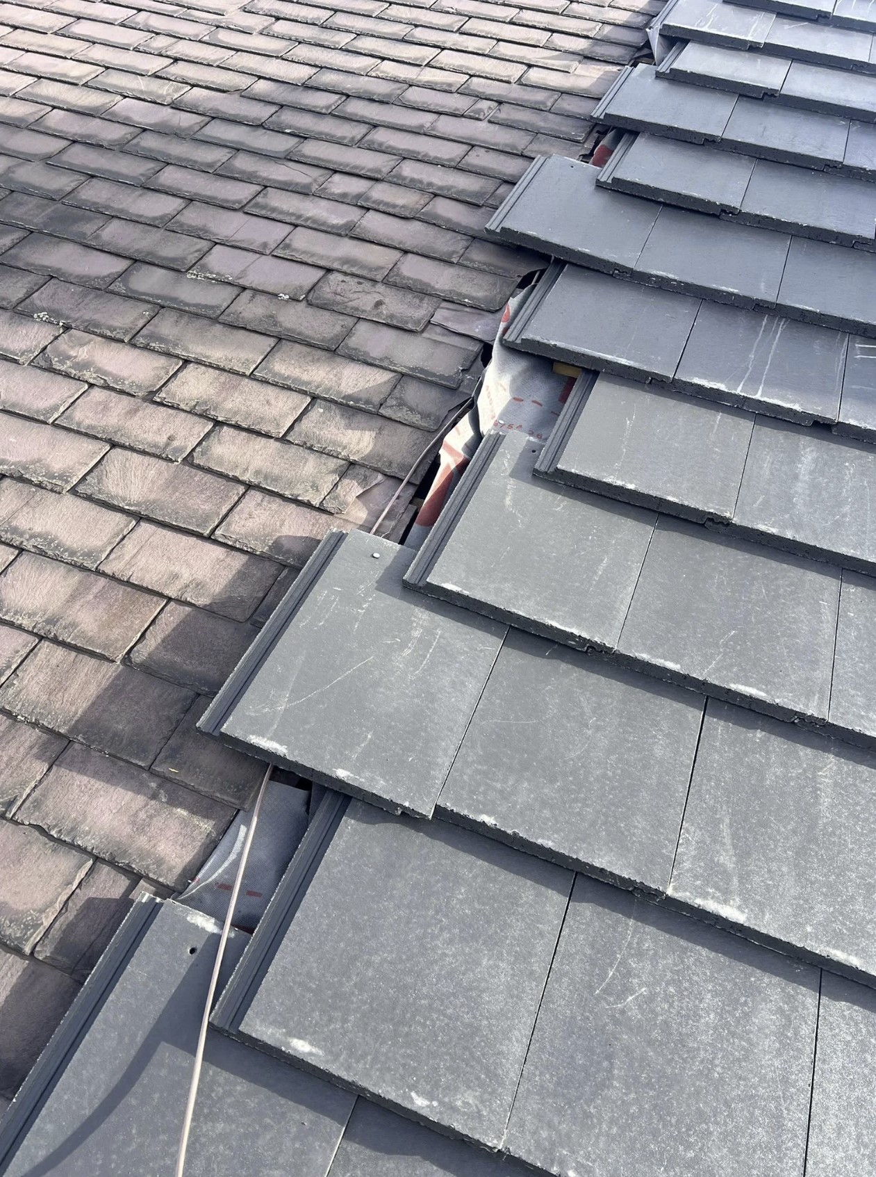

Roofer has joined marley ludlow tiles to my neighbours redland 49 is this o.k
18 Mar 2026
5
My Roofer has joined my Marley Ludlow tiles to my neighbours redland 49 without a bonding gutter says he has checked and this is o.k
Thanks for reply will just keep an eye on things as solicitor advised and if it goes wrong well its off to court
OP,
Unless you are bonding like for like then its best practice to use a bonding gutter.
The Ludlow & the Redlands might appear to have bonded but give it a bit of time and the join will probably leak.
FWIW: there's more to bonding a roof than just installing a bonding gutter.

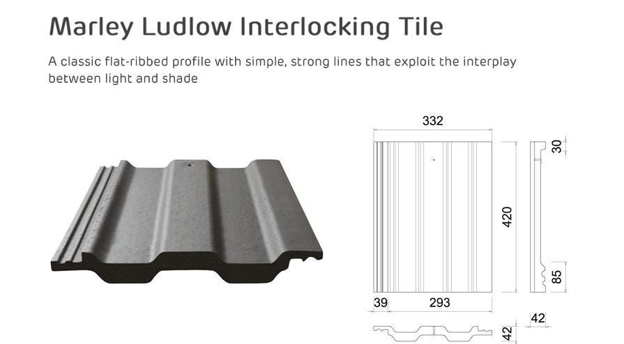

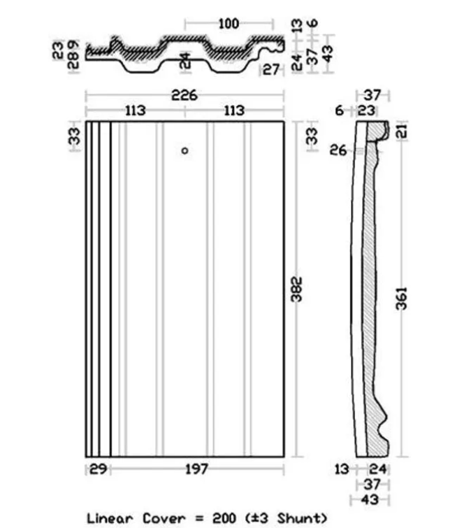

Looking at lap layout/dims they seem just about compatible and may cause less problems that fitting a bonding gutter and more aesthetically pleasing?

OP,
The Ludlow & the Redland are not compatible:
Their dimensions are different.
Plus the Redland has a camber.
Joining roof covers on the same plane requires taking care and time to do a correct job while giving attention to details.
Or else you might be clambering on the roof doing remedial repairs for many years to come plus the irregular join maybe red flagged by a future mortgage surveyor.
I would do my own check with Marley's technical chaps and unless they confirm it's fine get your man back to the job right.
Spoke to marley they said
Thank you for your email. Marley always recommend the use of a bonding gutter where two different tile profiles are being used within a roof. We are unable to guarantee that the join between Marley and Redland tiles will be weathertight.
But Redland said this is a common practice should be o.k
And solicitor says i just have to wait and see if it leaks before i can take legal action
Tha to me is the answer: the supplier of the new tiles won't guarentee the joint so you are at risk. This needs sorted now
the channels are different and a Marley Ludlow plus is dead flat and a 49 does have a camber from top to bottom .. but if it's a full line from bottom to top of the roof and not a mix . you might get away with it .
both are still available
When you say "if it leaks it's off to Court" I think you should consider discussing this again with the roofer and getting him back to do a proper job. If he won't co-operate then consider gritting your teeth and geting a better roofer in to fix the issue. This could end up cheaper than taking the original roofer to Court. It'll be VERY expensive and even if the judgement is in your favour there is no guarantee you'll get any action or money from ther original roofer - who'll probably claim he is no longer in business while restarting operation under a different name.
Thanks for advice will bear it in mind but i have legal costs covered on my insurance so if covered i should be o.k
I'm no roofer or builder but that looks completely wrong to me. Having suffered a persistent and mystery tiled roof leak myself over many years which eventually caused a ceiling collapse I would be very unhappy with that.
