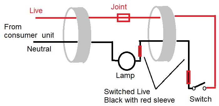

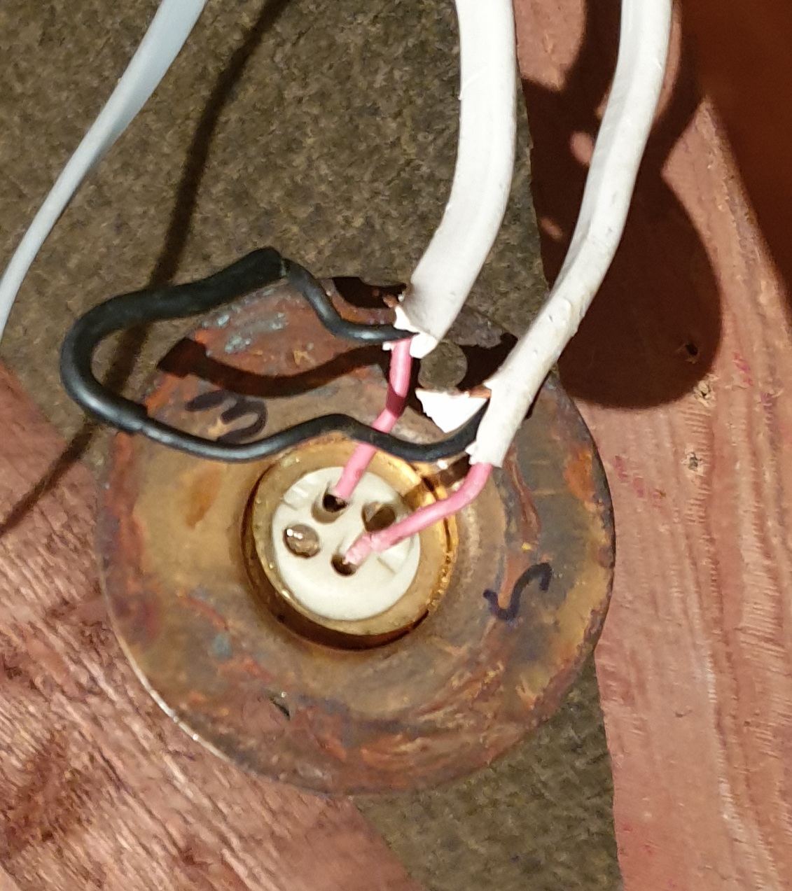

Are these wires reversed from traditional guidance? It's a very old light fitting in my loft being fed by a switch wire in the loft and the other from the circuit.
I'd expect to see the red wires creating the loop?
I want to replace it with a pendant so I can spur another light off the same switch. But looking at it, it seems the red wires are being used for the switch line and 'in' neutral. Am I seeing that right? Do I continue to use this 'wrong' way round in the pendant?!
The spur s going into a batten holder which I believe means the blue/brown wires can go any way round?
Thanks in advance!
If either of those Red wires is Live from from the consumer unit ( fuse box ) then you have the hazardous situation that the lamp holder is always Live even if the switch is OFF. The hazard is the possibility of an electric shock when changing the lamp bulb.
This is the correct way to wire that lamp.

Also the Earth wires ( the bare copper wires that have been cut short ) in the two cables need to be connected together and sleeved with green yellow sleeving

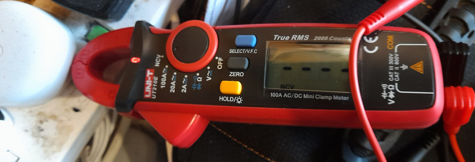

The neon screwdriver has saved me in the past with shared neutrals. Today the clamp on shown can detect that before a cable is removed. But full marks on the neon screwdriver advice.
Do you have relatively easy access to the connections? If so, it may be worth removing the existing wiring completely, starting again with new and doing things properly.
The switch wire yes, the circuit wire no... it comes from under boarding which has central heating piping handily over the top!
