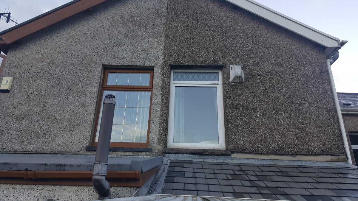

I live in a terraced house and yesterday evening my neighbor told me that he is removing the rendering on the back end of his house as there is a crack and water is coming into a bedroom. My side is completely dry. He says its only a matter of time before my side starts to crack and wants to take the render off on my side about 2 foot to the edge of the window so that the join is on my side his new render to my old render. I took photos close up of my render and it seems fine - no cracks etc.
I spoke to a mate who does some building work and he said that it would be a bad idea to have such a join on my side of the property and that the join should be in the exact middle and he told me to tell my neighbor that. my neighbor says that having the join in the middle puts his property at risk in the future. Wants me to contribute and agree to have the join on my side.
thoughts?
I enclose copy photo - my side is the one with the white window and he wants the join at the bottom of the edge of my window and up.

surely by putting the join next to my window it could cause issues for me in the future rather than having it straight down the middle where the existing join is - i assume new render does not fix easilly to old stuff
He nees to disk cut a vertical joint on the centre line, and insert a stainless steel bead joint and seal it with mastic. This would involve removing about 100mm of render on your side of the line so as to fix the metal bead in and render over it.
A Render Plus Pvc expansion bead would also work - and only need 50mm of render removing from either side of the line.

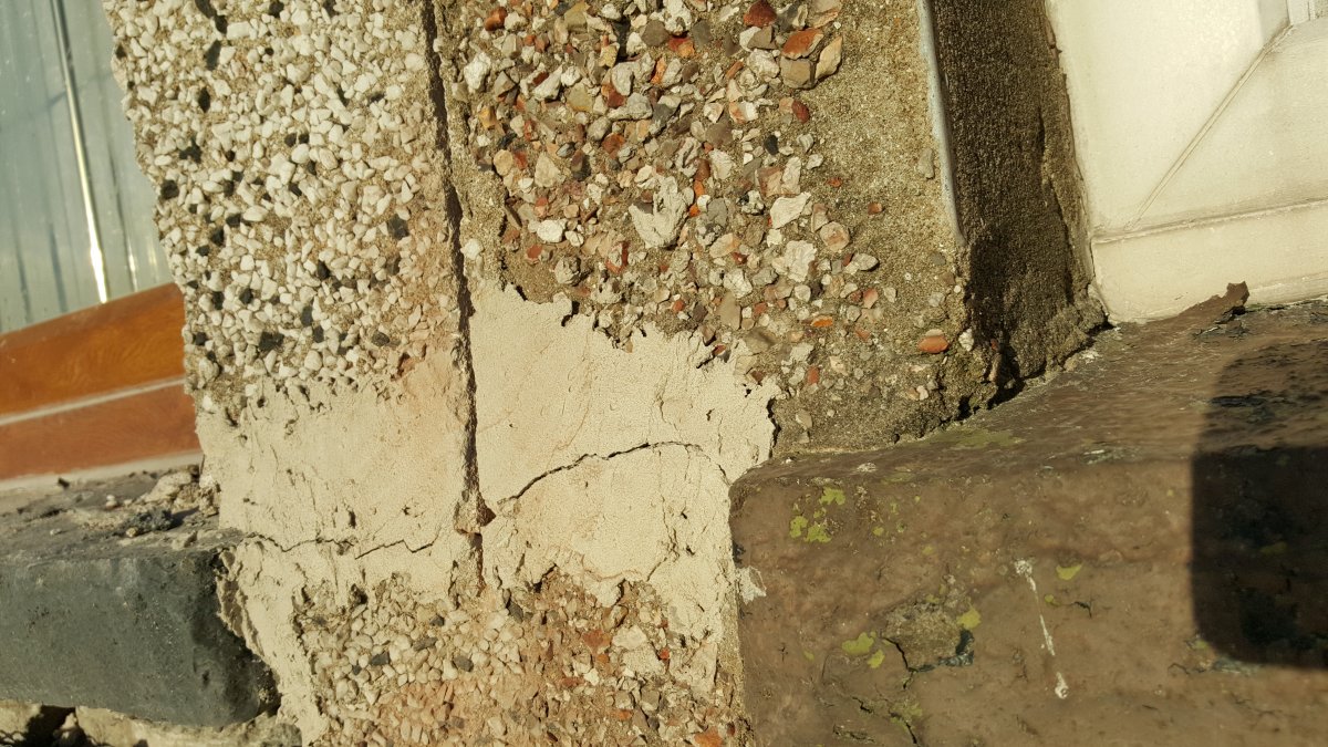

They have now cut a line down the middle. Their Builder wants £50 to patch a 5 inch square patch between the sills. He said it would be easier to cut across to my window at top but told him not to do that. He said my render was solid above the patch between sill.
Can I simply patch this piece myself . See photo below. I assume £50 is a bit steep

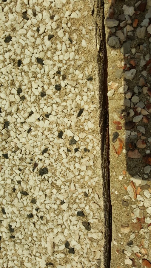

Whats intended with the slot, as advised above you need a 200mm or a 100mm wide chase- what next?
The rip should go down as far as possible without disturbing any lead flashing or bottom edge beading.
Previous, when the neighbour had his render/dash installed the plasterer made a crude sand and cement join between his new and your old render.

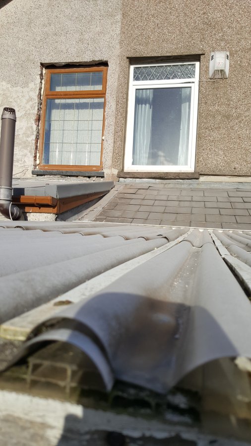

I'd suggest that the patch was caused by the removal of the neighbour's old window cill?
Your dash around the window reveal is in a poor way - it was maybe done when the window was changed to Pvc?
Your metal angle bead is exposed and will eventually rust out causing the render & dash to blow.

Here is the gap he has cut. They have now left for the day
