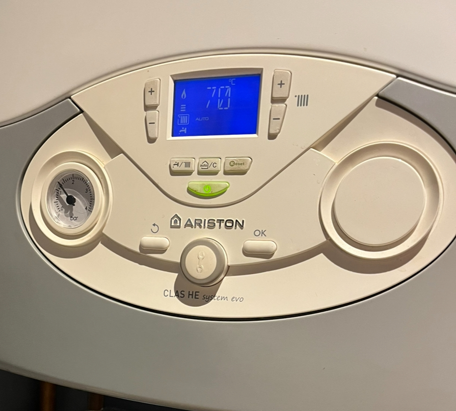

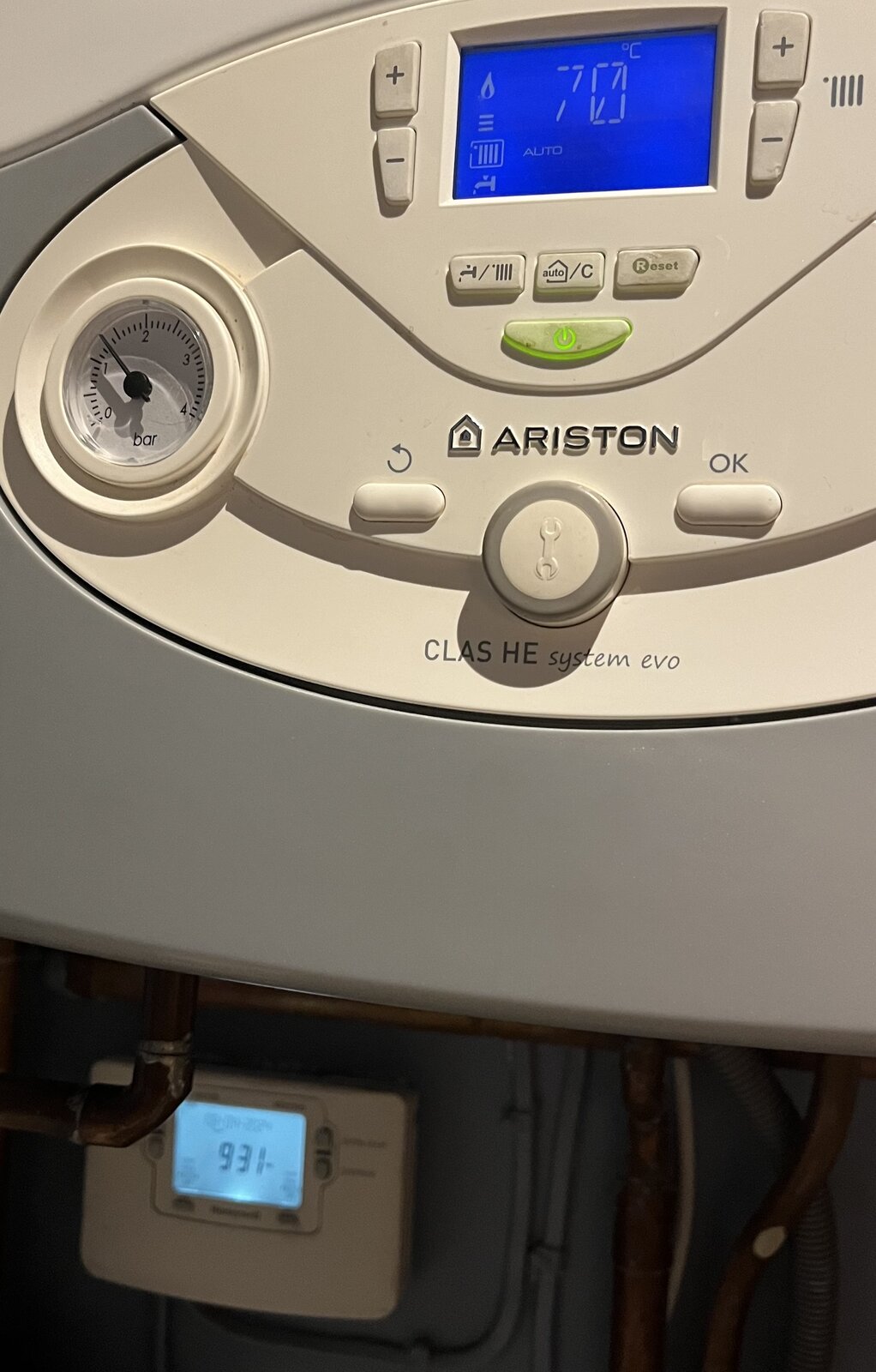

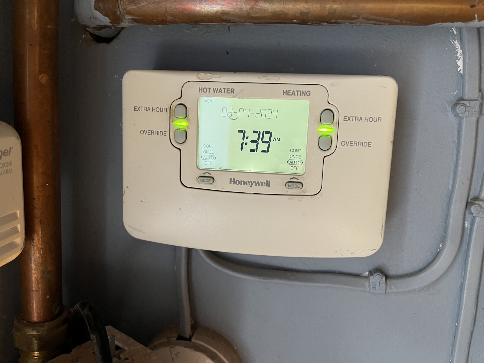

We have recently moved into a new house which has an Ariston Clas HE system evo boiler (without clock) operated by a Honeywell ST9400C timing control with separate walled mounted thermostat.
Each of the three items appear to be operating correctly, however, somehow the timing control does not appear to be controlling the boiler ie the timing control switches on/off and does not seem to control the boiler, which appears to be constantly on. On the boiler we have both the water and heating set to on, with the auto setting engaged.
Does anyone have experience of this? I am hoping we have just got one of the settings wrong somehow.

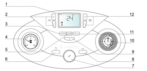

You don't show the full picture of the boiler controls. Usually there is a timeswitch included. Item 10 below.
If you do have the timeswitch fitted you now have two devices installed trying to do the same thing. The Boiler Timeswitch and the Honeywell Programmer. So, the timeswitch is usually taken out of service and the remote programmer can then take exclusive control.
Depending upon how the system is wired, that usually involves either setting the boiler timeswitch to be permanently 'on' 24/7 or sometimes permanently 'off' 24/7. Try both and see what happens, the Honeywell programmer should then control the boiler according to the demand for HW or CH. Assuming of course that it is wired in correctly.
Thanks for the fast response, Stem, appreciated. Have attached another pic, but there is no number 10 timeswitch, it appears to be one of the models without it.
So, from what you’ve said it sounds like I need to change from the ‘auto’ setting on the boiler and try it being permantly on or off and see which works based on the way it has been wired.

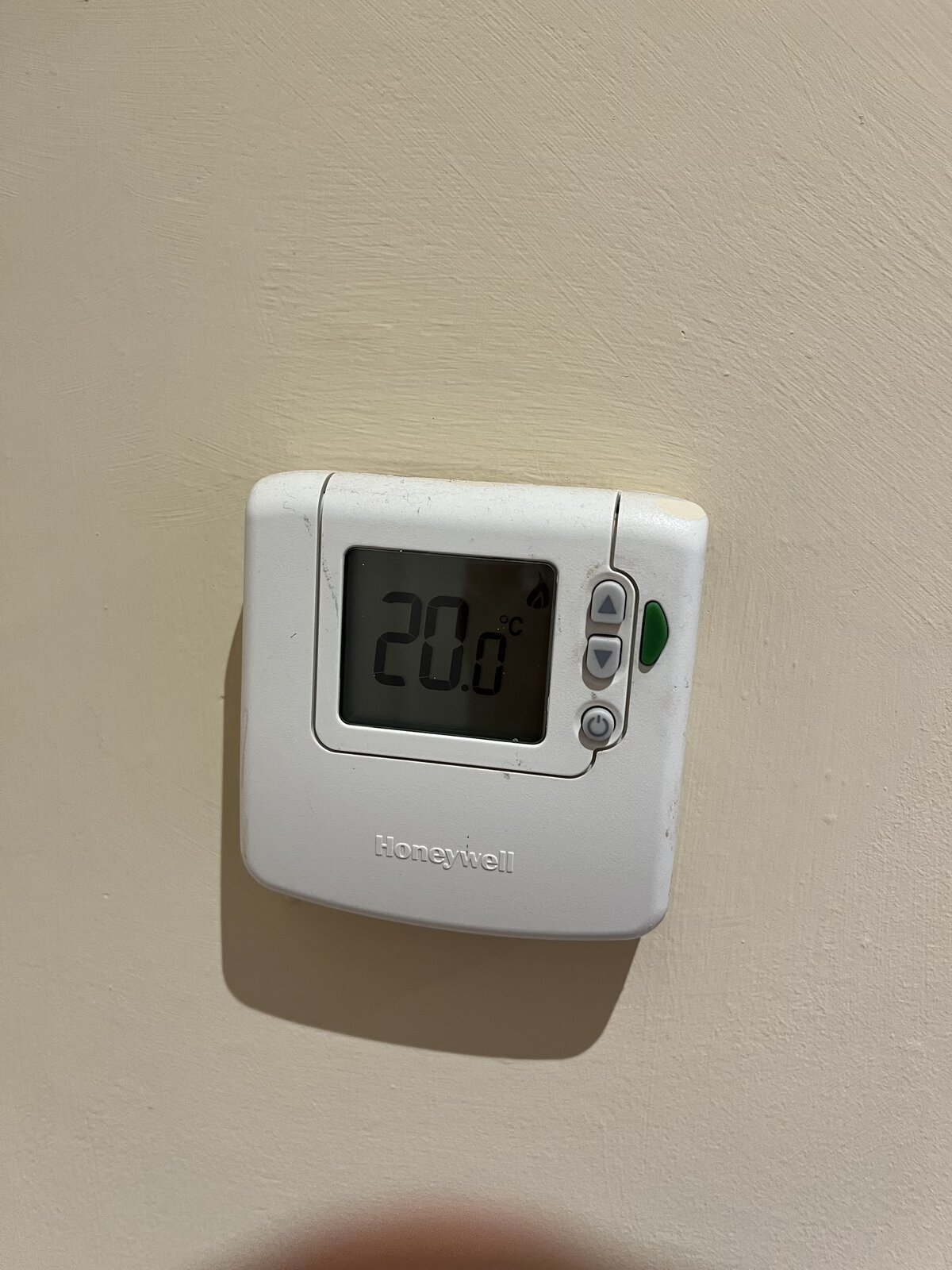

As far as I know only one thermostat on the ground floor. Albeit, the first floor has been running hotter than the ground floor, which I imagine could just be settings.
Yes, the Honeywell time periods are set up and appear to be working correctly, it just doesn’t appear to be communicating to the boiler / the boiler reflecting what Honeywell is saying it should be doing.
