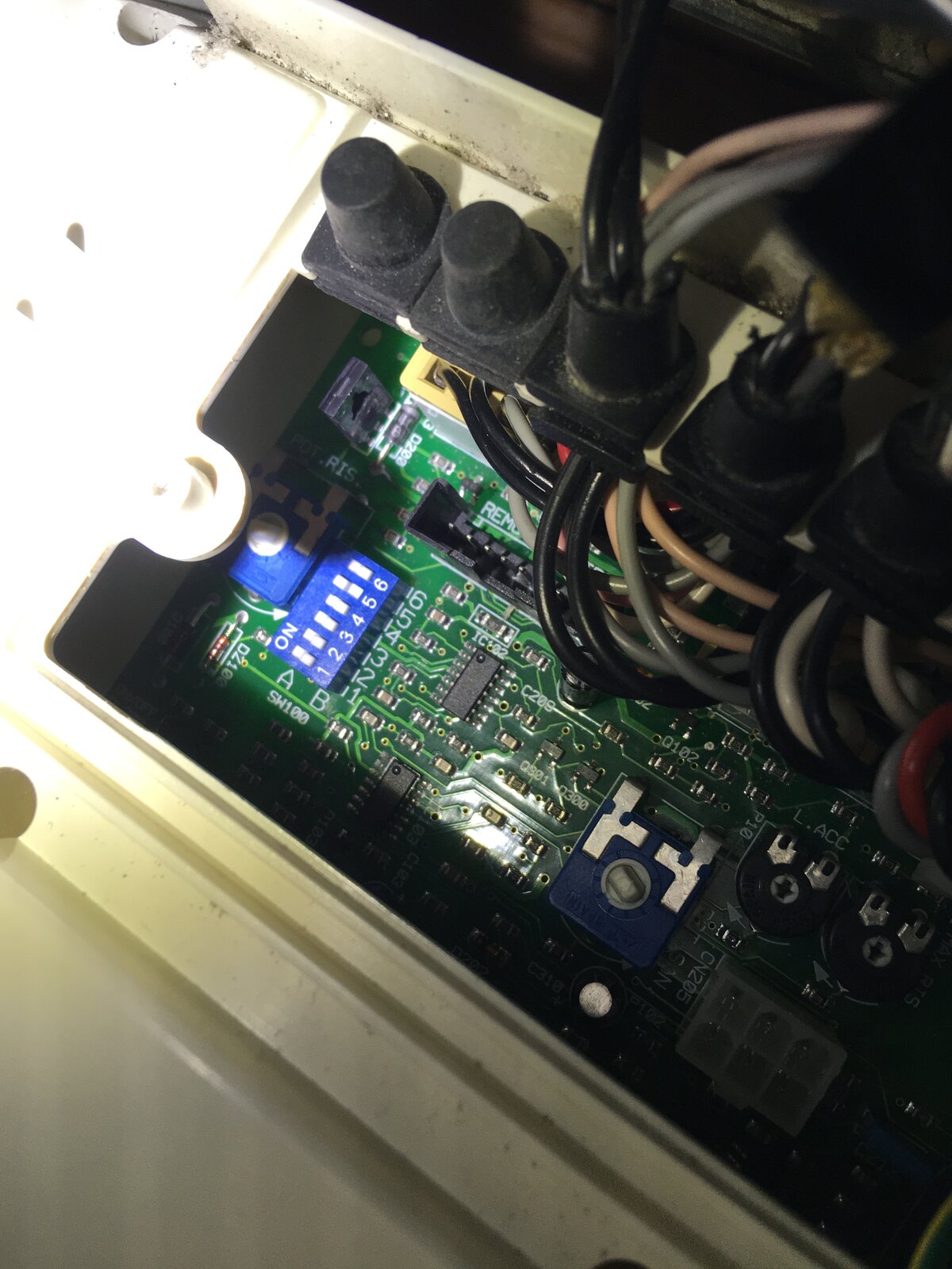

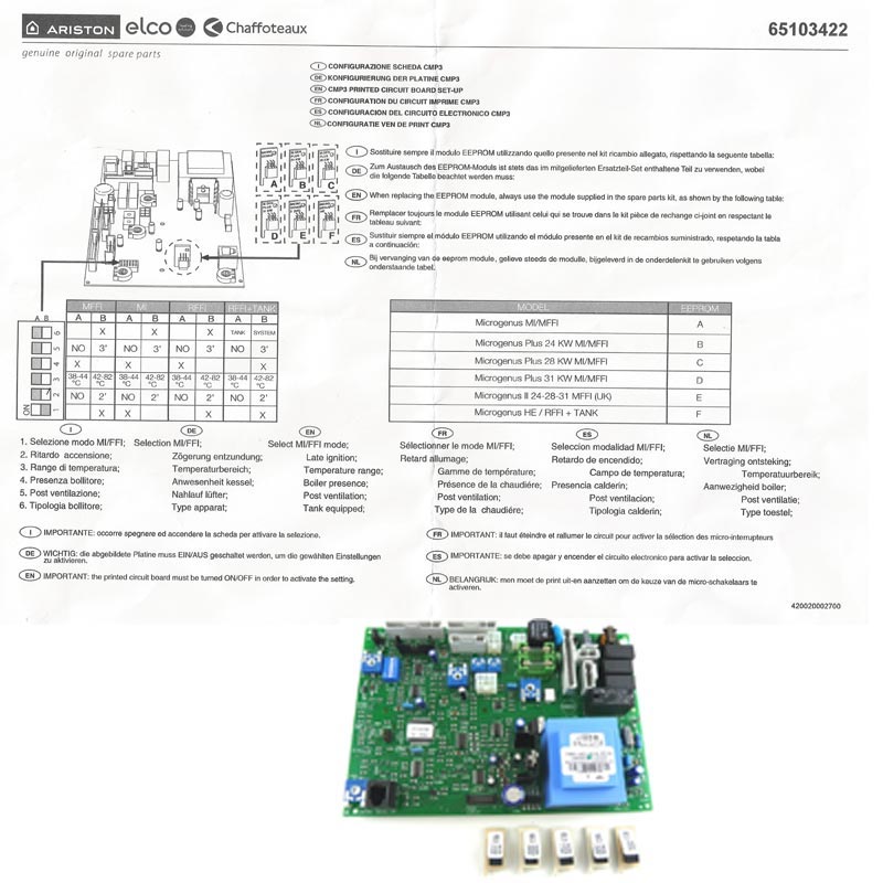

I've seen a knowledgable poster on here (Agile) who i'm hoping might shed some light. We've replaced the PCB on the boiler as we had no HW, that returned the HW and CH runs. However the on / off switch, reset and comfort switch don't do anything - the boiler is on even when switched to off. So trying to trouble shoot by checking it has the right eprom and then the settings for that eprom are correct on the pcb. Attached are two pictures one of a table of settings. The other the settings on our PCB. Currently they are toggle as below
  1. B
  2. B
  3. B
  4. B
  5. A
  6. A
But I can't understand if that is correct. The eprom inserted is for the microgenus rather than microgenus 2 (UK) all other eproms were different kW rating.

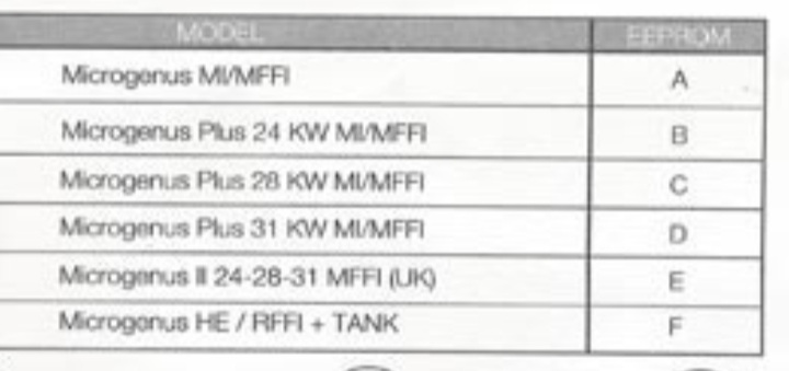

You have a Microgenus 23 MFFI.
Out of the EEPROM choices:
Only EEPROM A matches.

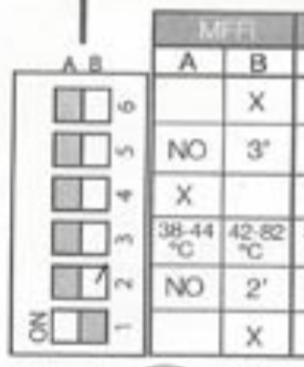

As for the dip switches, the shadows suggest they are set to:
1. B
2. B
3. B
4. B
5. A
6. B
As your model is the MFFI, that refers to the first column of the table:
Where X marks the position the dip switch should be in, where your model does not have that specific function fitted.
So my guesses are:
1. Select MI/FFI mode (no choice). B
2. Late ignition (currently set to 2 minutes). B?
3. Temperature range (currently set to 42 - 82C). B
4. Boiler presence (no choice). A
5. Post ventilation (currently set to none). A?
6. Tank equipped (no choice). B
So, I believe the only switch you need to change is 4, to A!

It does thank you, agree that it might not change the switch. Could be something more pedestrian like the spindles in the switch not engaging the switches on the board so will double check that
