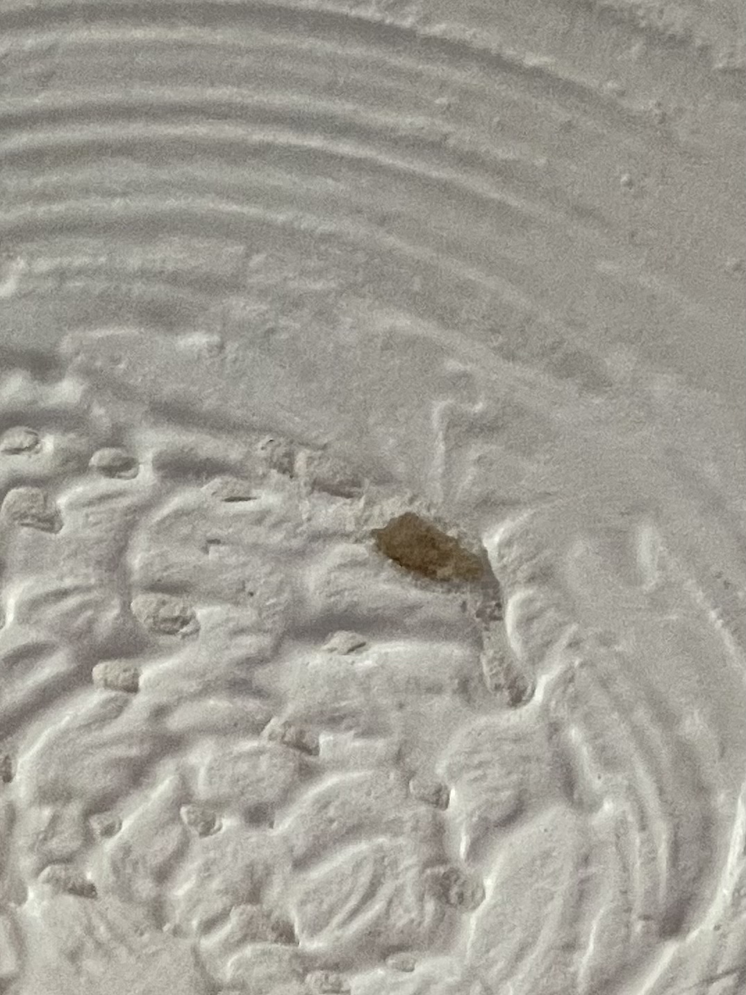

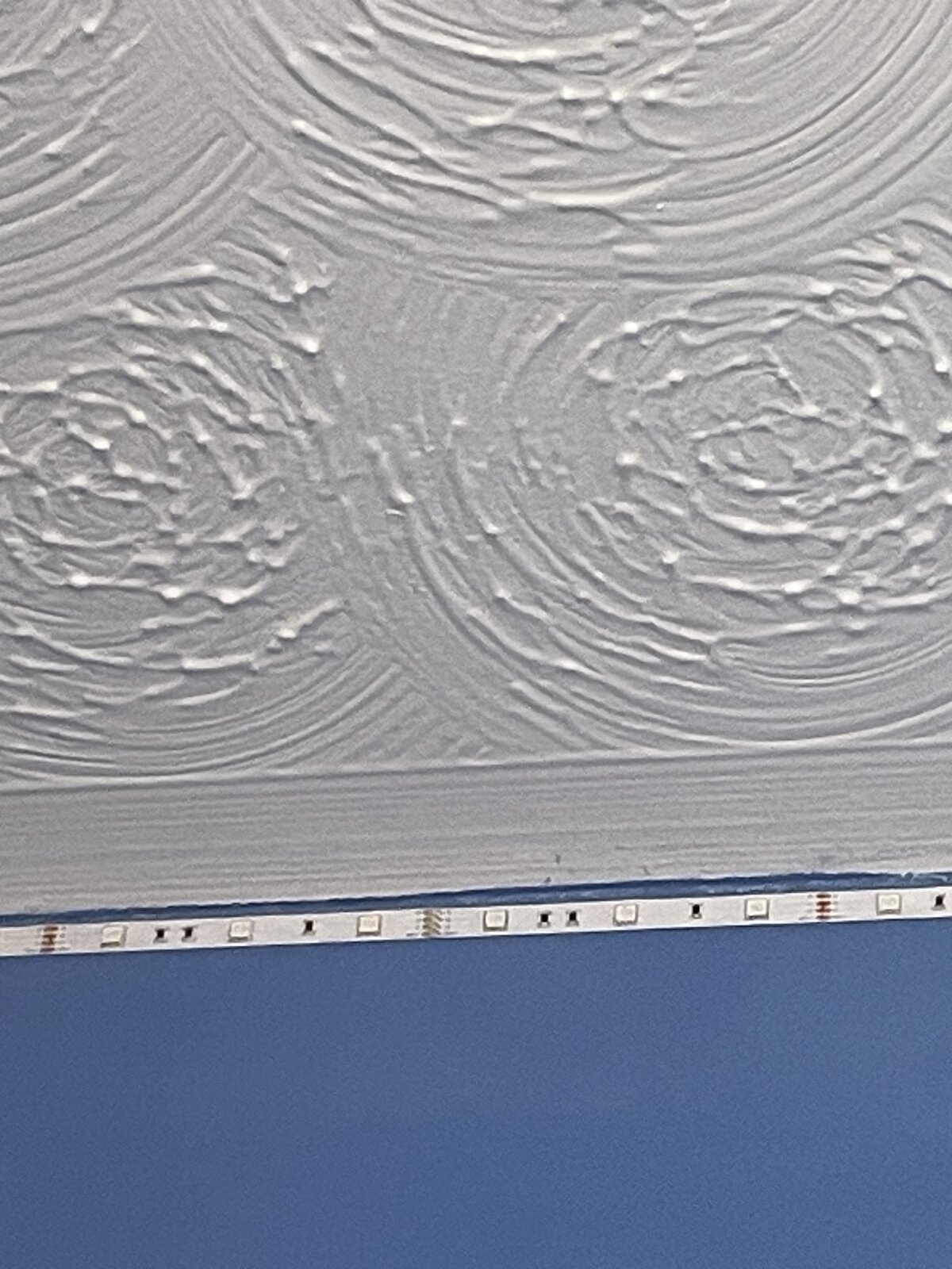

1985/6 house (think built by bovis homes) what’s the chance of Artex containing asbestos?
*if you shine a light where points have come off it’s got tiny shiny bits in
No, sorry. You send it to be tested. In the UK laboratories are accredited by UKAS, a government appointed organisation for various things like testing, assessing, certifying and calibrating. The categories they cover are numerous and extensive but you can find the list of organisations they've accredited for asbestos testing here:
