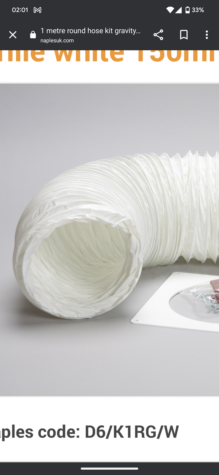

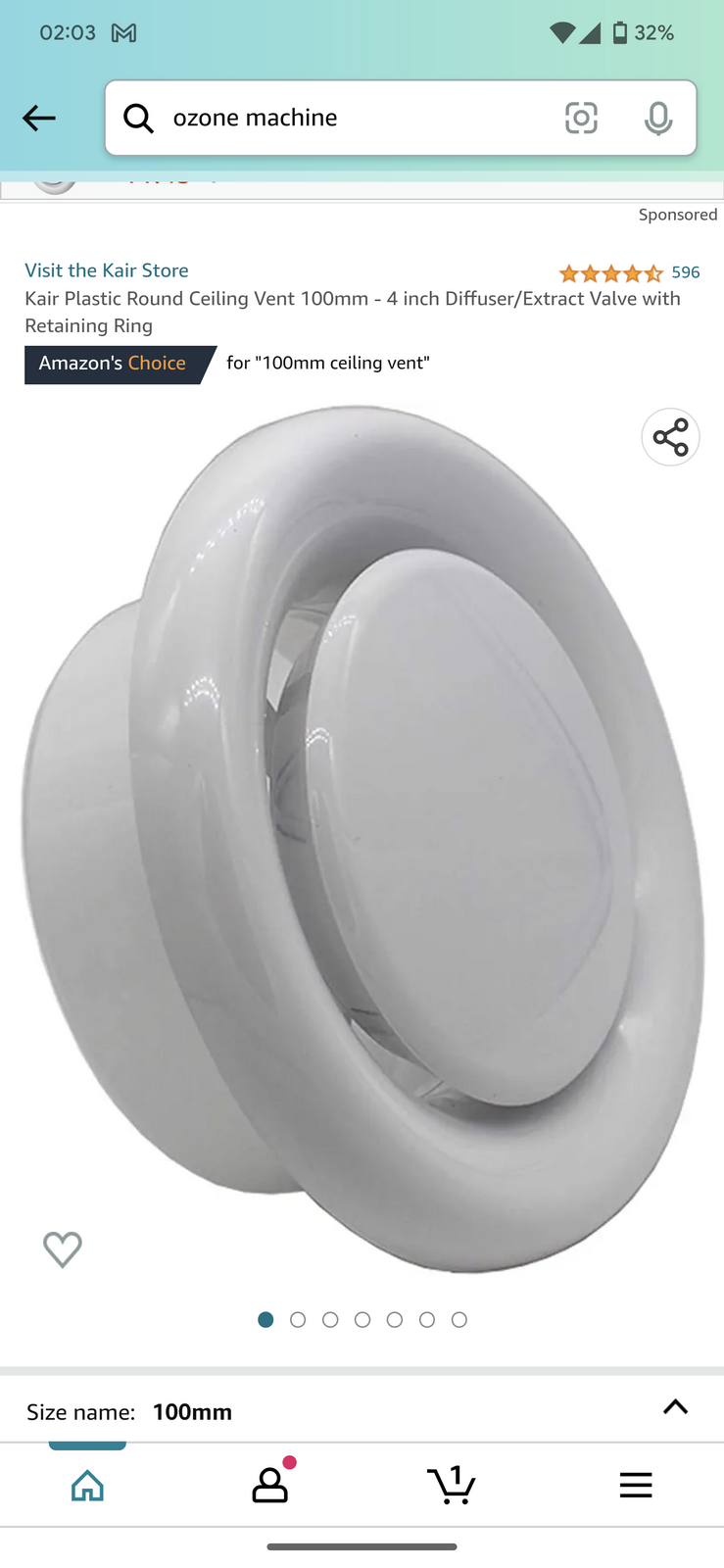

so there's these vents I'll uploads pics or similar to explain but can the asbestos come back through the vents?
They're round similar to below with the flexible tube onto them.
Very unlikely.
I'm guessing the ducting/vents you have posted are to do with ventilation, and will be a a sealed loop/system.
