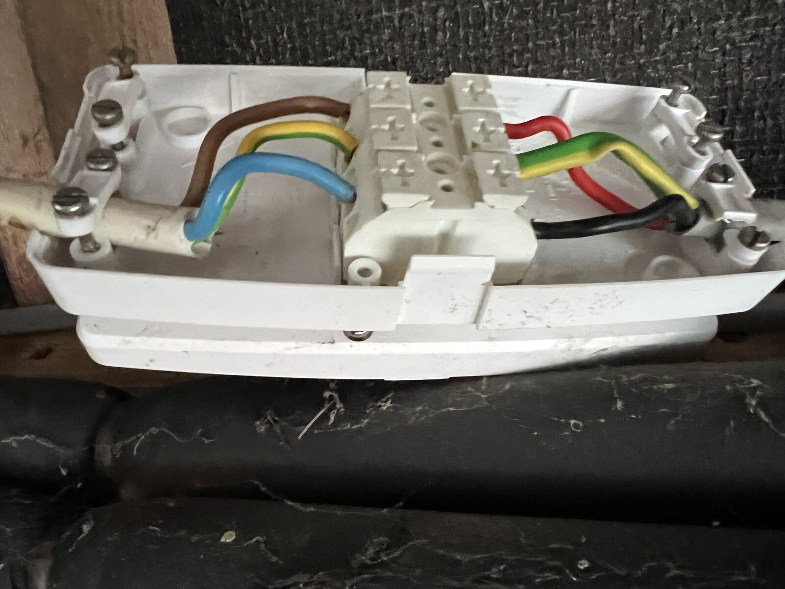

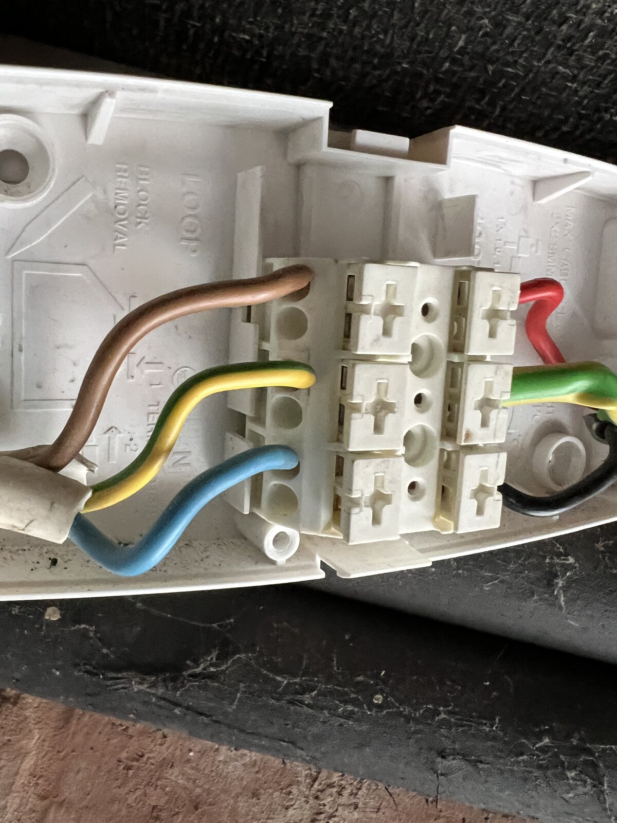

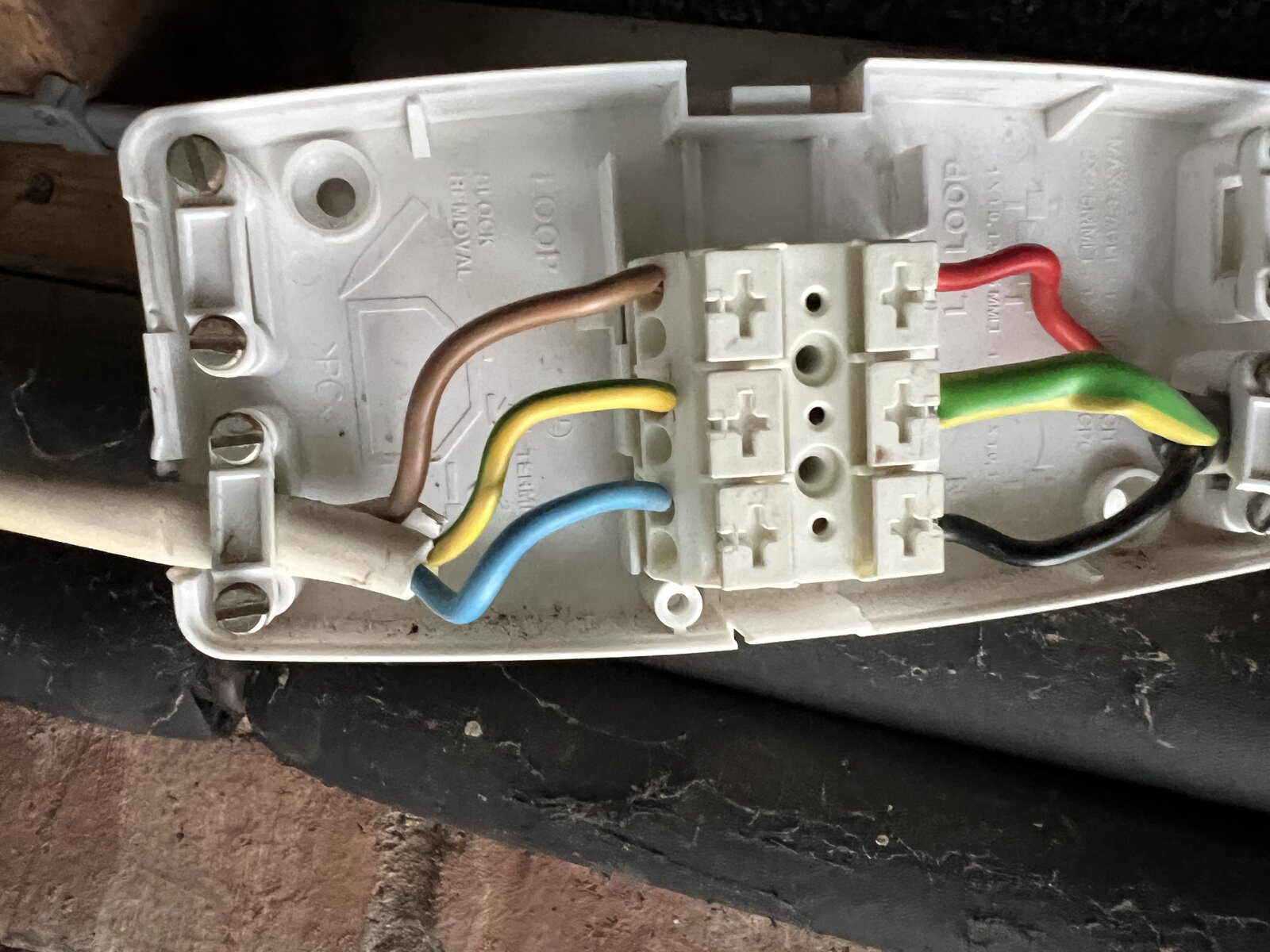

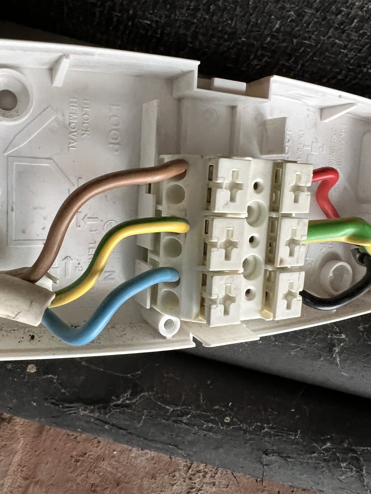

Hi all,
I’m trying to disconnect the output side of an Ashley J803 junction box as I’m wiring a security light. I opened the box and was greeted with this:
I cannot for the life of me figure out how to disconnect this junction box! The little plastic connectors that I am pointing at in the final photo are removable- they slid out when I popped a screwdriver underneath them. But I can see no way of disconnecting the wires and they won’t pull out! Any ideas? I don’t want to just cut the whole thing off, I’d like to reuse it if I can!
push down on the plastic button on top of the connector block and pull the wire out. IIRC you have to push pretty hard.
Worked, cheers!!!!!
