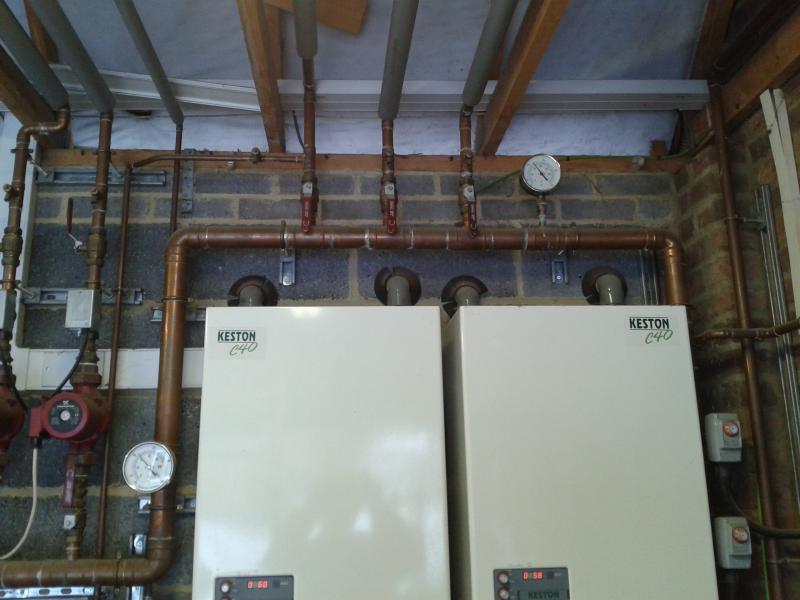

Hey Brightonboy , here's a couple of keston C40's we installed circa 2004 , designed and speced by an average domestic 'plumber'. :LOL:
Max flow rate through 'header' is around 0.95 l/s @ a DT of 20c , now more importantly velocity through header is around 0.45 m/s.............

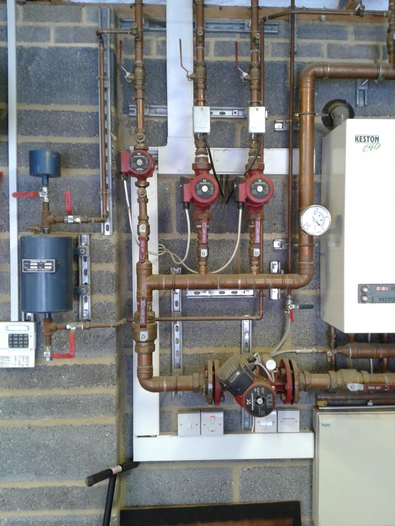

All my own idea. Including the electrical panel that gives the system hot water priority when the cylinder depletes to certain level.
I can promise you that there is less than 12 inches of 28mm tube in the whole room ;)
Nonsense !!! With two headers and one boiler the Flow and Returns from each boiler should be ideally the same length as one header may grab more flow than the other..

"two headers" :mrgreen: , I thought you said in a previous post that you were well aware of the difference between 'headers' and 'manifolds'? , clearly not. :rolleyes: :rolleyes:
