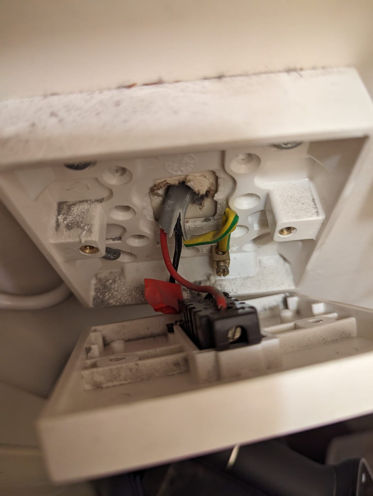

Hi,
I've moved into a house that has downlights built into the soffit, they can be turned on via a switch inside the house. Id rather these be automated...is there a way I can achieve this?
It's fine with either a timer or a light sensor - whatever will be easier. I can access any cable attached to a downlight but struggling to locate where they start from.
I've looked at a device called sonoff but not sure if it would work

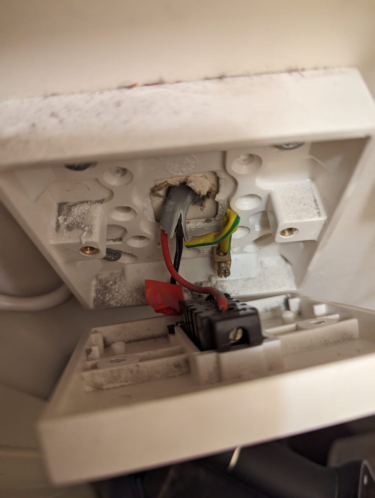

Just seen pictures, likely you will need spacer or swap back box for a deeper one. But Tapo would work fine as no neutral required.
All I want is is it to turn on and off at a different time or on in the dark and off in the day. Please see pic for switch wiring. Thanks

Just don't know which route the cables go from the switch so hard to find the part in-between switch and first light
So the device I have suggested would do as I outlined and would need to be positioned outside "looking" away from the building so it can sense the changes in light
If you are able to get into the loft it has probably been dropped through there Then its a question of identifying a location for the pir, and cutting the existing cable, switch end with live feed into permanent live, the other end live feed into switched live. Don't know whether that will create disruption but it should work ok if everything drops down from loft to soffit

However the timer shown will not really work, as you have no neutral, this switch will 1727432415415.png it needs a hub 1727432470221.png so total cost £17.70 x 2 = £35.40 from CPC who ever they are, so far more expensive, I assume you have a router running for other things?
But the cost to run a neutral is likely more than the extra you need to pay for the smart switch and hub, so it does seem a reasonable method to do what you want. Add a button, £14.10 and Hub also works as door bell. And logs each time rung on your phone. It is not classed as water proof, but mine has been there for over a year and no problems. The same button can also turn on your lights, so both rings the chime and turns lights on.
