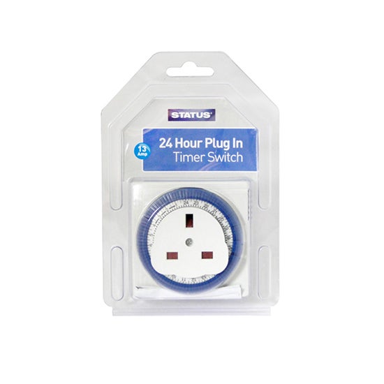

Use a plug-in timer switch

I have a B&D Firestorm drill,probably 10 years old by now. The charger packed up several years ago but charge time was 5 hours. No indication of charge state, just a light on to show that it was charging. I used a timer with it. 7 hours would be ok but I'd question 12. The multimeter suggesrtion is a good idea except that nicad batteries should be charged in one go I believe.
