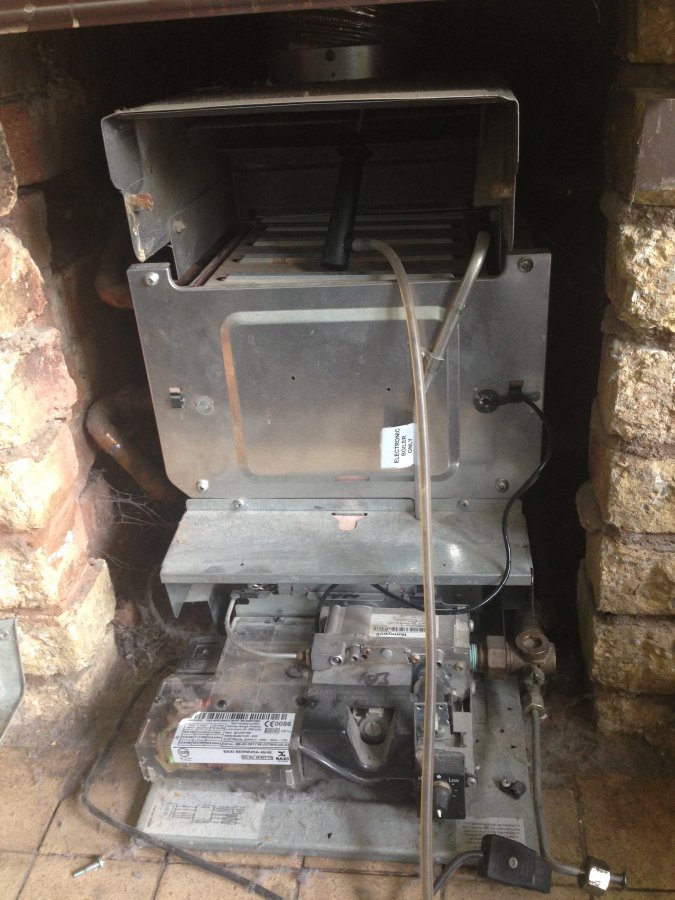

To be fair that's passed me by then, I still take 0040 / 0080 ratio readings on all open flued boilers.
whats it got to with baxi?, do you guys not bother using one on any boiler that predates the invention of fga's and has no dedicated test point?
I guess for me I like to know its clean after I've done it, that the fuelsaver hx I've masked up and scrubbed and washed isn't producing 2k + ppm still, gently wafting across the outside seating area from the balanced flue. Or that the highflow balanced flue isn't so rotten at the spigot that it'll be sooted up again before I get off the drive or that a prima flue I cant see throughout isn't corroded and about to begin vitiating. So peace of mind for me I suppose, just cant imagine why anyone wouldn't do it.
Where from? There's no test point.
As above. Where do you take a correct and accurate reading from on them and how? Do you do it with fire front off?
MIs trump all and there is no need to take an FGA from these.
