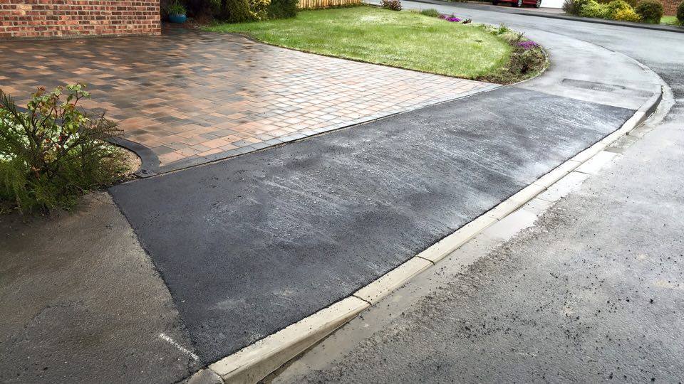

Had a bit of a Google but couldn't find much info. Basically I built a block paved drive at the front of my house and paid my local council install the drop kerb, which has been completed today while I was out.
Just wondering if it's normal for the tarmac to be higher than the existing surface by about 1 cm at the edges? I kind of expected it would be flush with the existing footpath.

Handlaying tarmac is a lot harder than it looks, you can never get it quite perfect. Not like concrete that you can fiddle with until you're happy. I did a stint helping on road repairs a few years ago on the Council, we always used to leave repairs slightly proud, it will consolidate over time and will wear in level.

Looks fine to me, as mentioned it will bed down. If you're that worried just go out an belt it with a lump hammer a bit.
£1100 is quite cheap for a dropped kerb guess they must have got the cowboys in :D
It's not your responsibility for the path outside your house, it's what they have done and it's to their spec. You may be able to get someone out from the council to have a look at it but i doubt if they'd come out or do anything about it.
