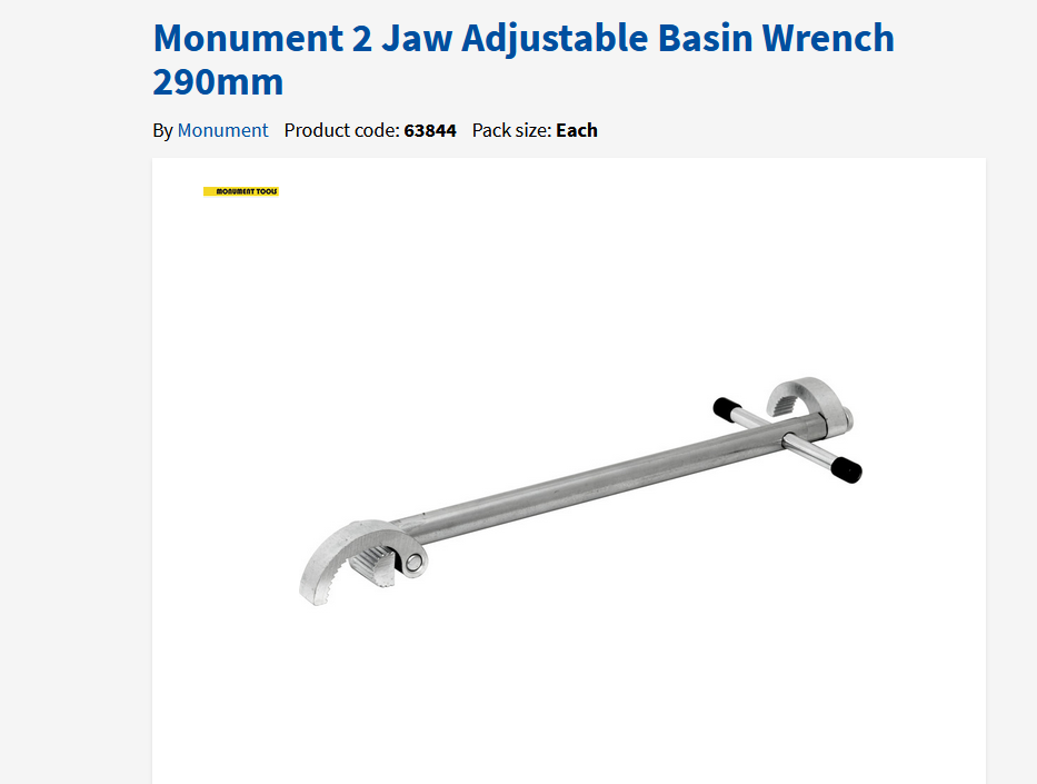

Hi all,
Need to check I am not being dim - I have had a Todays Tools TT Professional 1/2"-3/4" Tap Back Nut & 15-22mm Compression Fitting Set lying around for ages (one of those things that someone else was clearing out and I thought might be useful someday), however, when it comes to changing out an already fitted tap (with pipes in place, etc) it doesn't seem to have the correct fittings to loosen the backnut already on the basin (there are two included, one too small and one too large...)
Am I being dim? Surely if the kit is made for this purpose it should fit? Is there an adjustable version of these that I can get to avoid future pain?

Would something like this not work? Relatively cheap...
Yes it would but you still have to get the supply pipe connection of of he tap to then loosen the backnut and lift the tap clear. Again though, you still have space constraints.
It might if you have the room to turn it, one of these will definitely do it.
https://www.toolstation.com/monumen...MIwIGsuu7U7AIVF-DtCh31tQD6EAQYASABEgLb5fD_BwE
