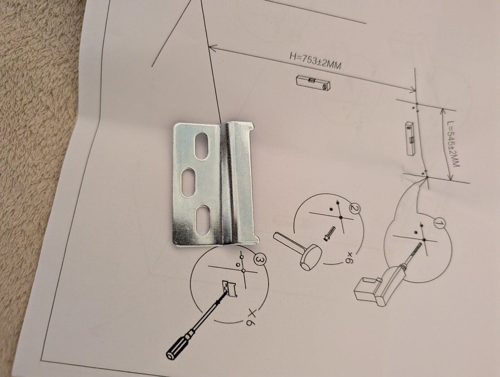

1) what screws would be sensible here would the duopower 8x65 plugs with the supplied 5x80mm screws be adequate as the picture for the brackets?
2) do I need to put all 3 screws to each bracket or can I get away with 2 screws per bracket

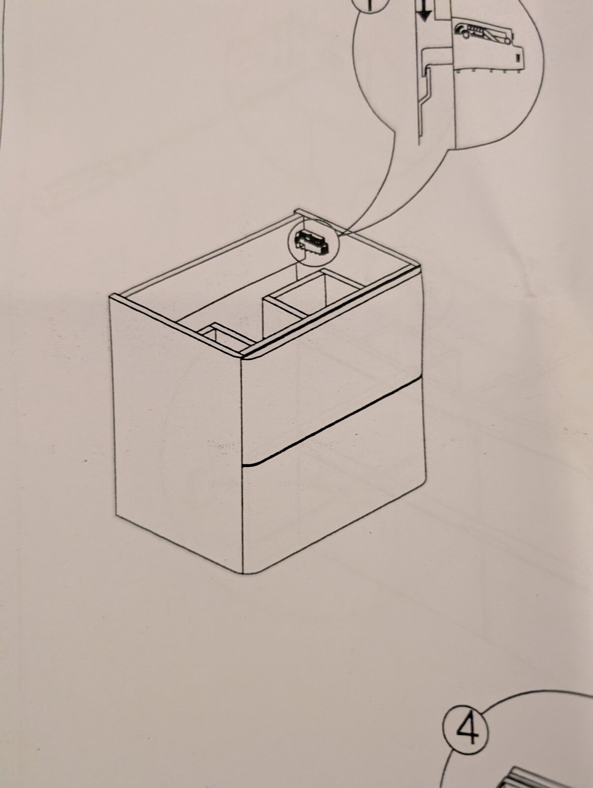

The instructions show all 3 holes used, so I'd go with that. 5mm dia screws should be fine.
I suppose the galv steel brackets go direct on the wall, but not 100% clear to me. Those plugs look like they're tapped in flush with the wall surface, but if anything 80mm long screws seems overkill.

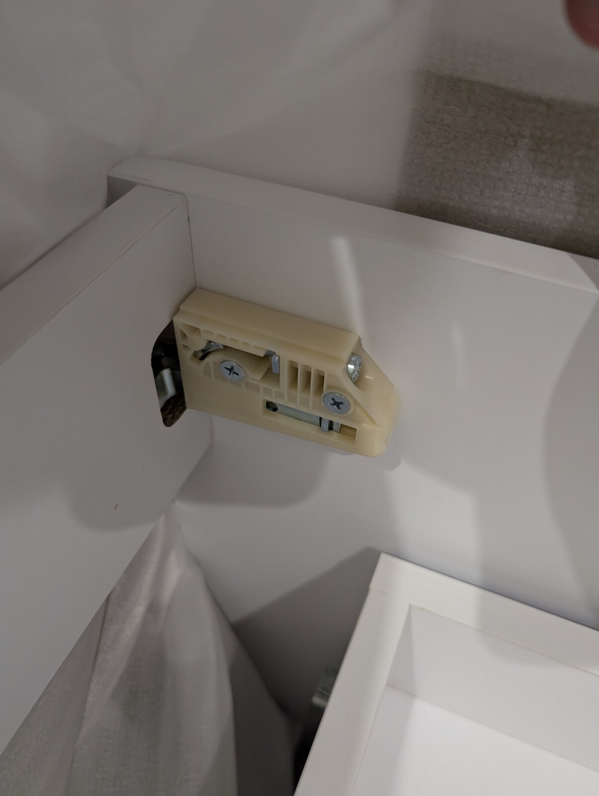

Yes the bracket goes to the wall and then adjustable hangers from the unit hang onto the wall brackets.
