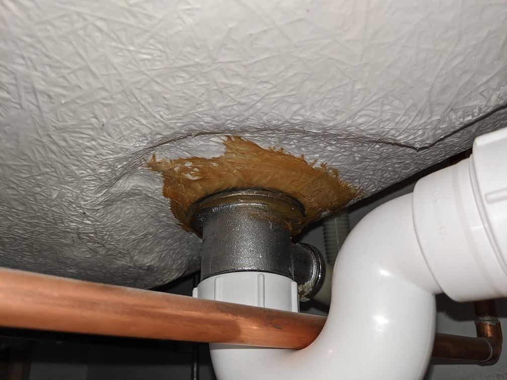

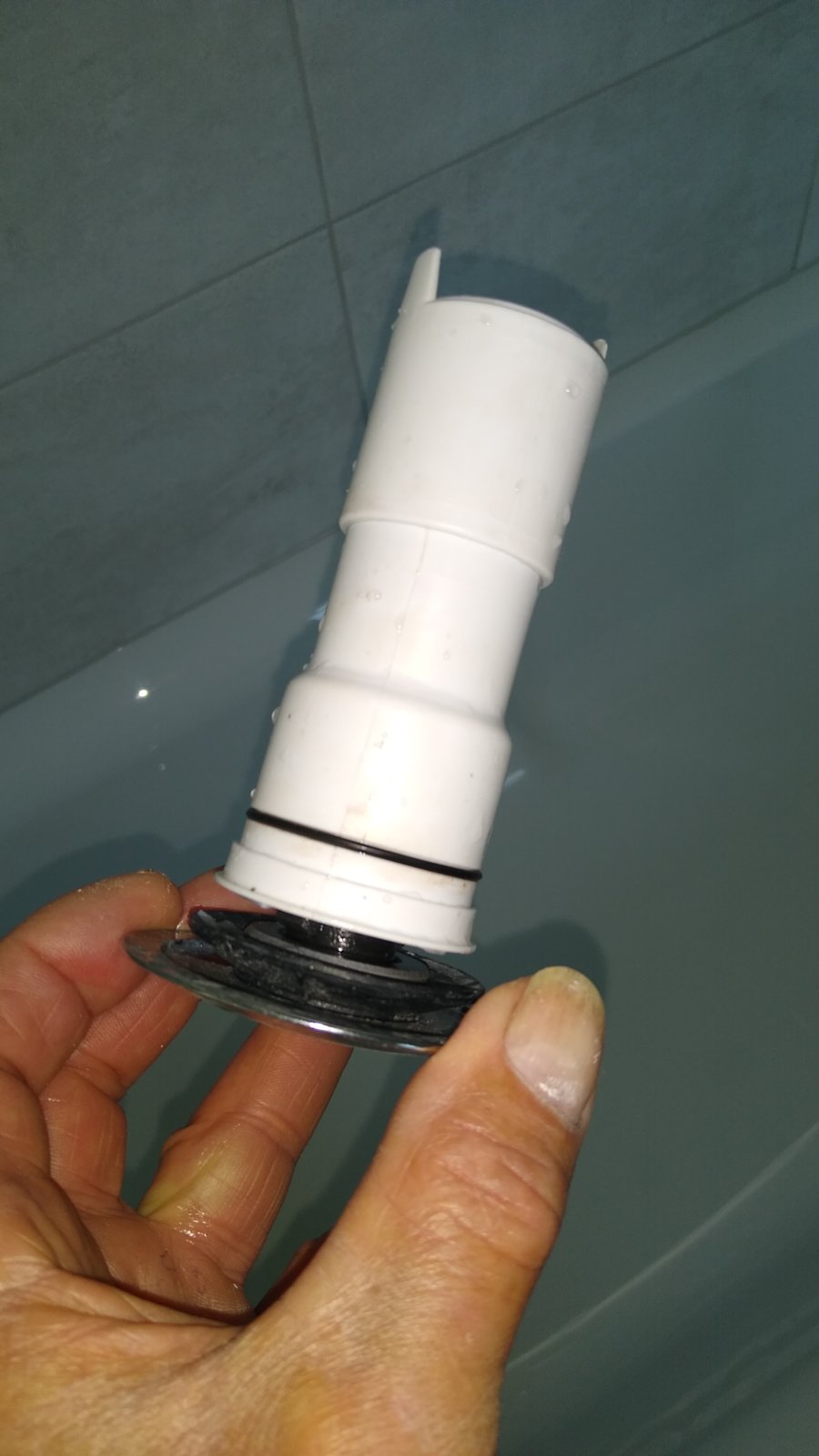

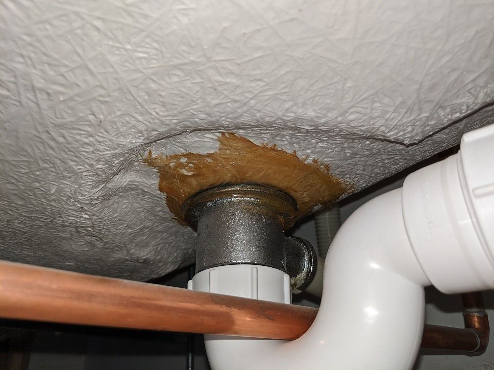

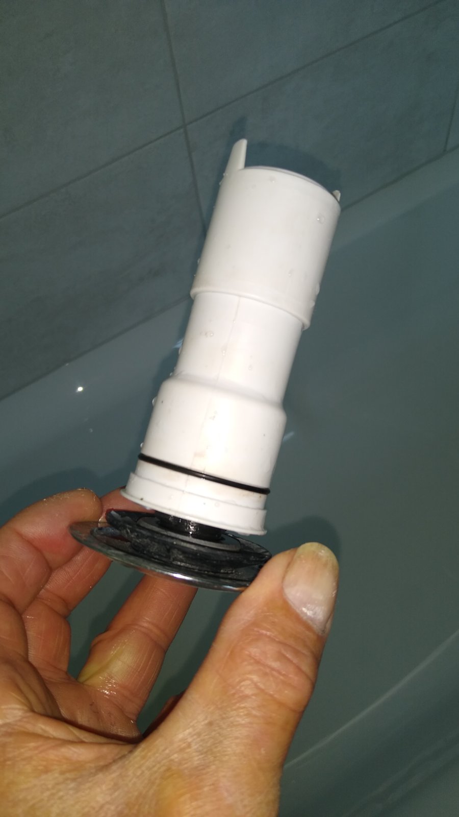

Popup is the one you described earlier where something controls the position (twisting the overflow or pushing/pulling a pin) and click-clack is where you directly press the mushroom bit. I have the latter; there is a spring loaded male based pin in the waste part which screws into the (female) mushroom part. The male spring loaded bit has snapped inside the waste housing. Will take a pic later.
IMG_20200505_182429122.jpg Have you checked its not a serviceable from above waste where one can remove the innards including the popup mechanism ?
Nope, definitely not serviceable from above! The whole thing is brass. And definitely had it as the spring is rusted and so snapped in half.

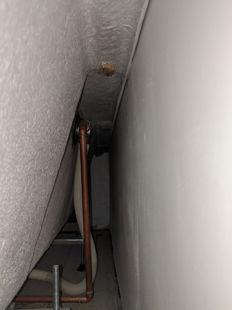

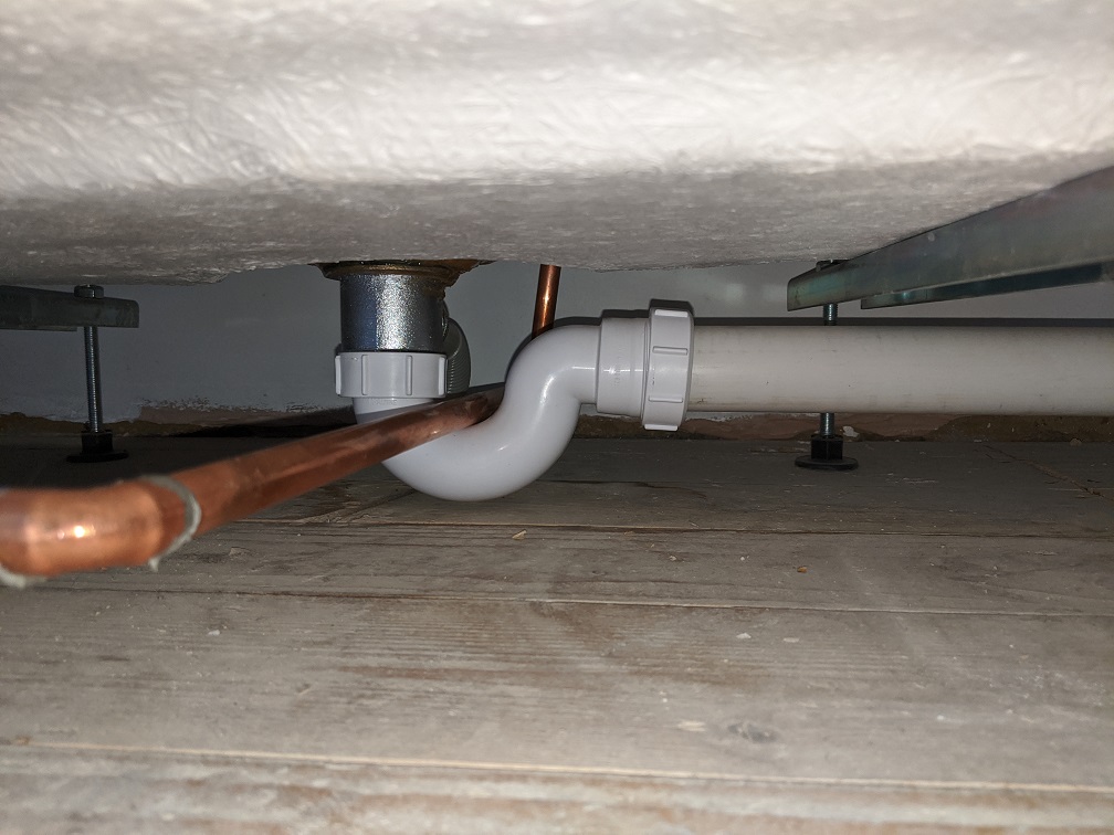

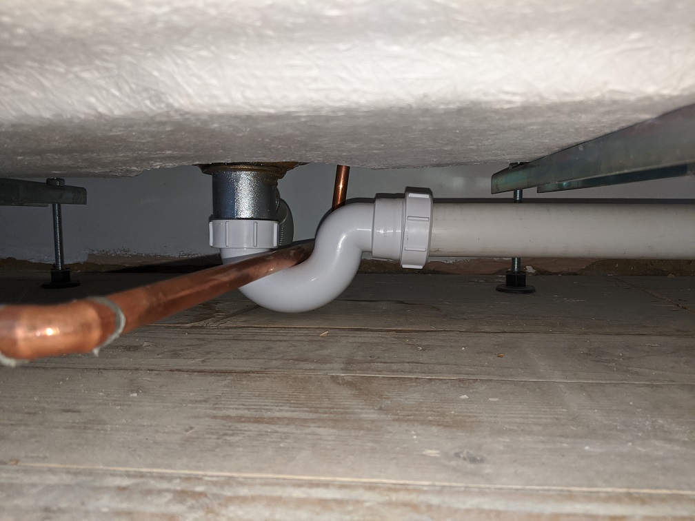

Took some pics of behind and underneath. I reckon once I take all the pipework out of the way underneath I'll be able to get close enough for a complete replacement, as long as the overflow is secured all from the front.
Clearance between floor and bath is 120-125mm.
