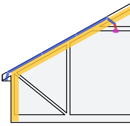

I'm doing a loft conversion, first layer of insulation almost done, bar a few small bits where I still need access to behind the insulation. I now need to install ventilation for the shower. During the build, I didn't install actual roof vents (the ones you swap out tiles/slates for) for numerous reasons, but thought I'd run ducting (blue line) behind the insulation (yellow line), down to the eves. There's a standard of ducting called System100 (example), 110x54, that would be ideal for this use case and is what I was intending on using.
My assumption is that the water vapour is going to condense quite rapidly once it passes through the insulation, so I need to ensure the run is water tight... this is where I'm having issues:
- The actual ducting only comes in 1m, 1.5m and 2m lengths and the main run behind the insulation is just over 3m, so I would have to have a join or two (white dotted lines).
- All of the joiners are female to female, not what you want for a downhill ducting run.
Since writing this, I've changed my mind about what I think the best way forward is, but I'll continue with some of my original ideas in case it gives others something to improve on:
- Flare the top end of each length with a heat gun and wooden former to make a built in male to female connection and use PVC pipe cement to weld the joins. I've tested this on a scrap bit I had laying around and it does work, it's just not ideal.
- Use the female to female couplers and just use PVC pipe cement to make a seal. I've tried this too, but wasn't able to reliably get a completely watertight join, so also not ideal.
Now I've written all that out, it sounds even more daft. I'm now thinking that I need to use another system.
I've looked at regular guttering downpipe, all the couplers are male to female and you get lengths of 4m; problem solved... except the size...
The standard diameter for a bathroom fan is 100mm (a cross-sectional area of 7853mm2), the 110mmx54mm ducting gives you 5940mm2 (only 75% of the area of the fan, though they say the airflow is better and this doesn't matter) and standard square downpipe is 61mm, giving you 3721mm2 (only 47% of the area of the fan), so the downpipe idea specifically seems like a bad solution (unless I run two lengths side by side... giving 94% of the fan area, but this feels super crap and has it's own issues).
Do you get double width down pipe (I know that sounds stupid)? Is there a different system I can/should use? Any other thoughts or ideas around anything else I've mentioned?
