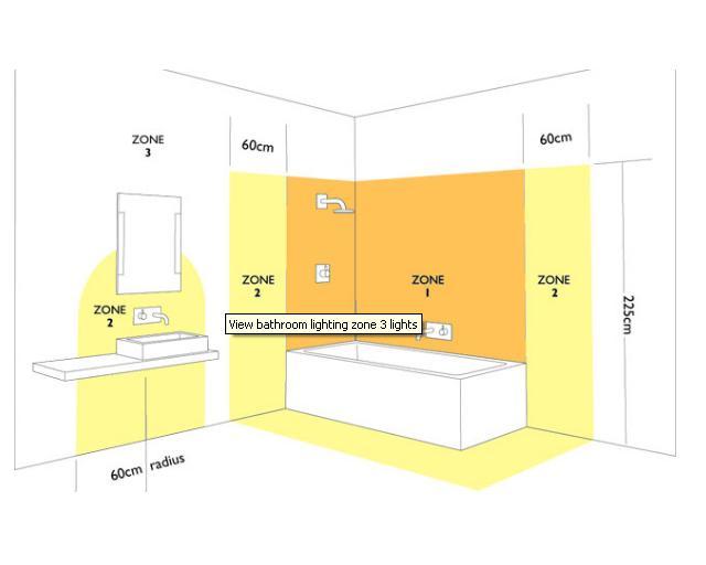

I have 3x LV down-lighters in my bathroom, my ceiling is 2400mm high - so from what I can see this makes them neither zone 1 or 2, so they need not be special fittings - please correct me otherwise.

My lights are in Zone 3:
So do they need any rating ? (ie IP65 for zone 2, IPX7 for zone1).

Zone 3 no longer exists has not for over 4 years.
If the IP ratings are suitable for the zones and the MI states you can install them in a particular zone then you should be okay.
Zone 1 and 2 should have to be at least IPX4.

My diagram was scraped off some lighting co's site, looks like they need to update their info, I have 17th edition Explained & Illustrated book, and quite rightly shows no zone 3, according to the book my down lighters are not in any zone, so as the only thing in a zone is the fan - that is ELV - I assume I do not need to install RCD protection for that ?
Yep.
Mind you - it was never right, there never were any zones associated with washbasins, they made that up.
