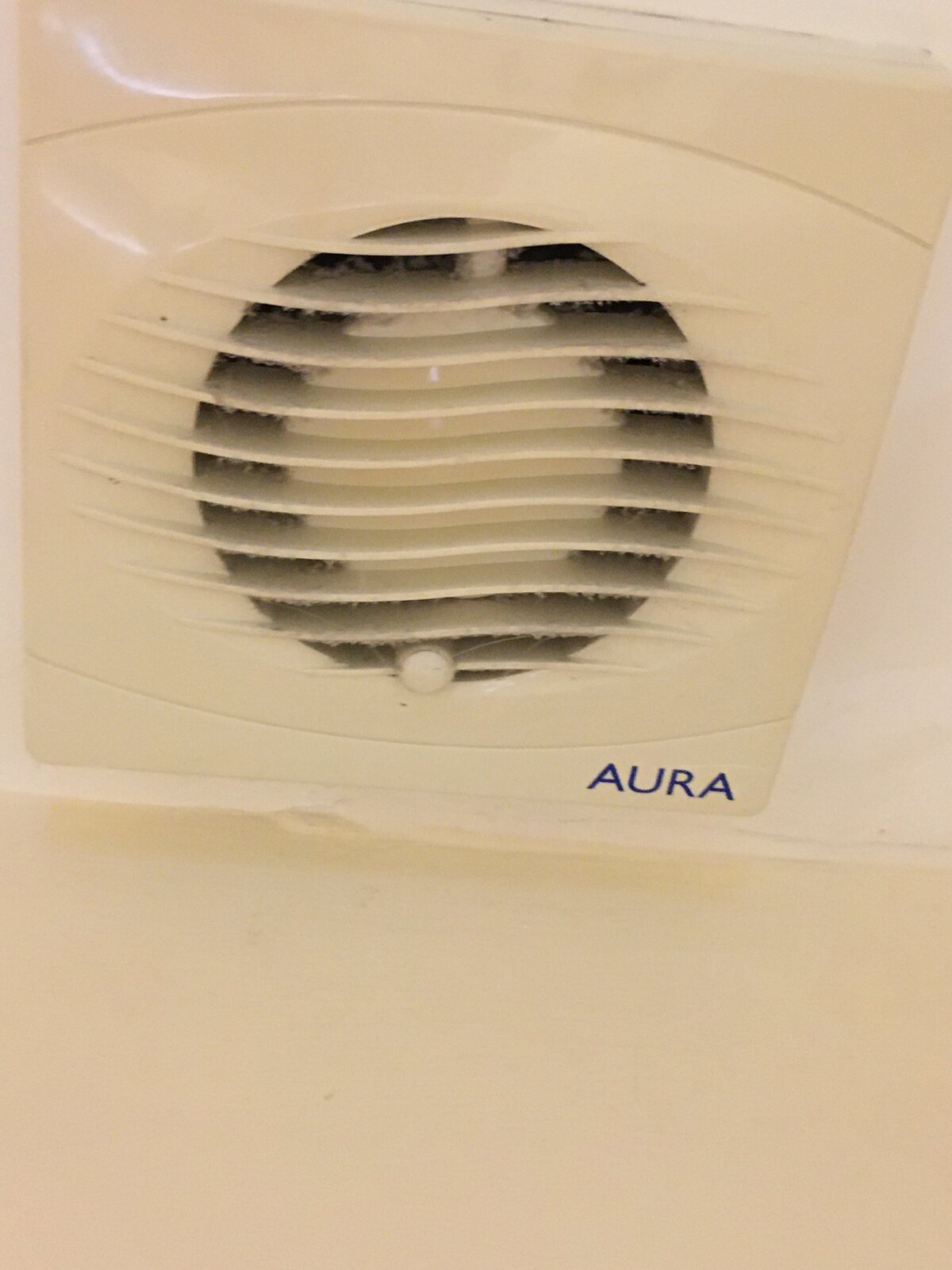

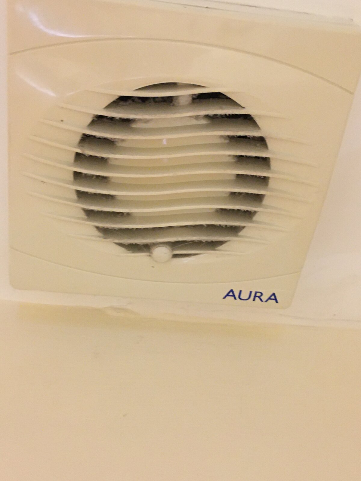

If by false you mean plasterboard then yes it is. This is mine, possibly same company but changed logo? It’s a bath with shower mixer attached.

that looks different, but IIRC Airflow amalgamated/took over some other manufacturer. Aidelle maybe? And the model may have a similar name but be different. Yours looks older. They did have some centrifugal models but it looks like your fan is in the centre of a 150mm square, so is probably axial.
Does yours seem noisy? Tech has improved dramatically in the past few years.
Take a photo of the ducting above the ceiling please. I think you probably have room for a better one.

Fan has been in about 10 years, but yes did seem quite noisy. It went even noisier before it stopped altogether.
