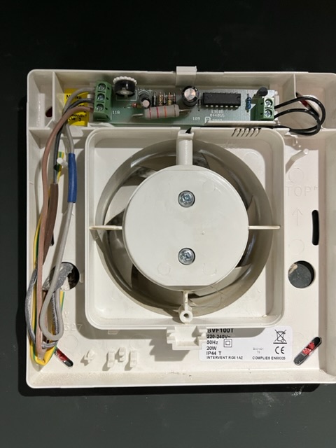

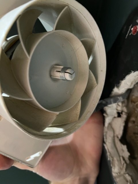

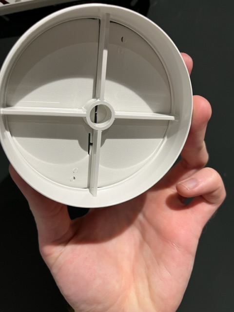

I just tried to a dummy run.
The back draught shutter stopped the airflow but it had to be at an angle to stop the flaps from being open. But then the extractor fan wouldn’t connect to the shutter so then the fan didn’t work.

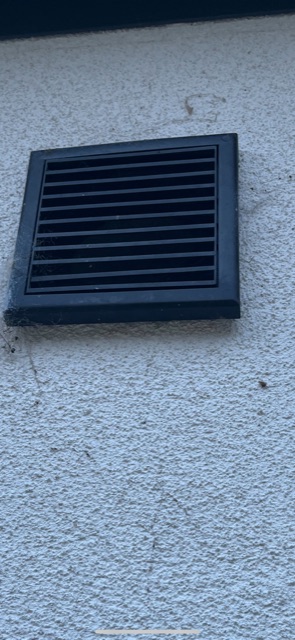

This is what the outside looks like.
Reckon it would be easier and less chance of a rattle to change it to something like this?

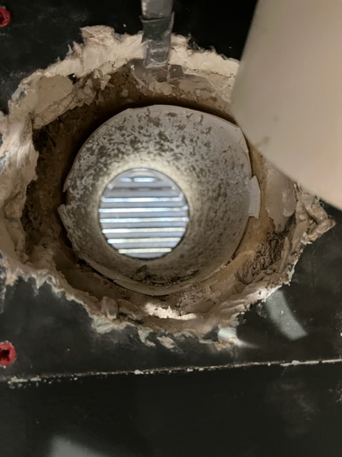

The air flow is coming straight from outside. It looks like the outside is just a guard to stop any dust or animals.
Yeah, go for one of those.
Those little airflow shutters work best in the vertical. They have very light springs to ensure the don't flop over themselves but are not the best in the horizontal.
A better version for horizontal use is similar but is just one flap on a 60/40 hinge.
The photo of the cavity isn't clear but, i have the same (brown) shutter as yours on my kitchen vent as it's high up (away from animals) and is great for high output fans.
For your bathroom fan, might be ok. Might not. Mine rattles in high winds if we leave the kitchen windows open. (Flow through).
I'd say the brown one is fine.
However, make sure to sleeve through the wall properly. Ensure condensation can drain. If i remember my set up correctly, i left the sleeve slightly proud on the external side and seal accordingly.
Do make sure to sleeve the wall properly though, sealing well on both sides. Not doing so creates all manner of issues.
Oh, and if you sleeve with proper ducting, (100mm ID) you can use draught excluder tape on the fan spigot (97mm id) to seal.
