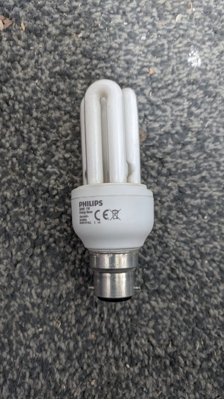

It's a Philips Energy saving bulb.

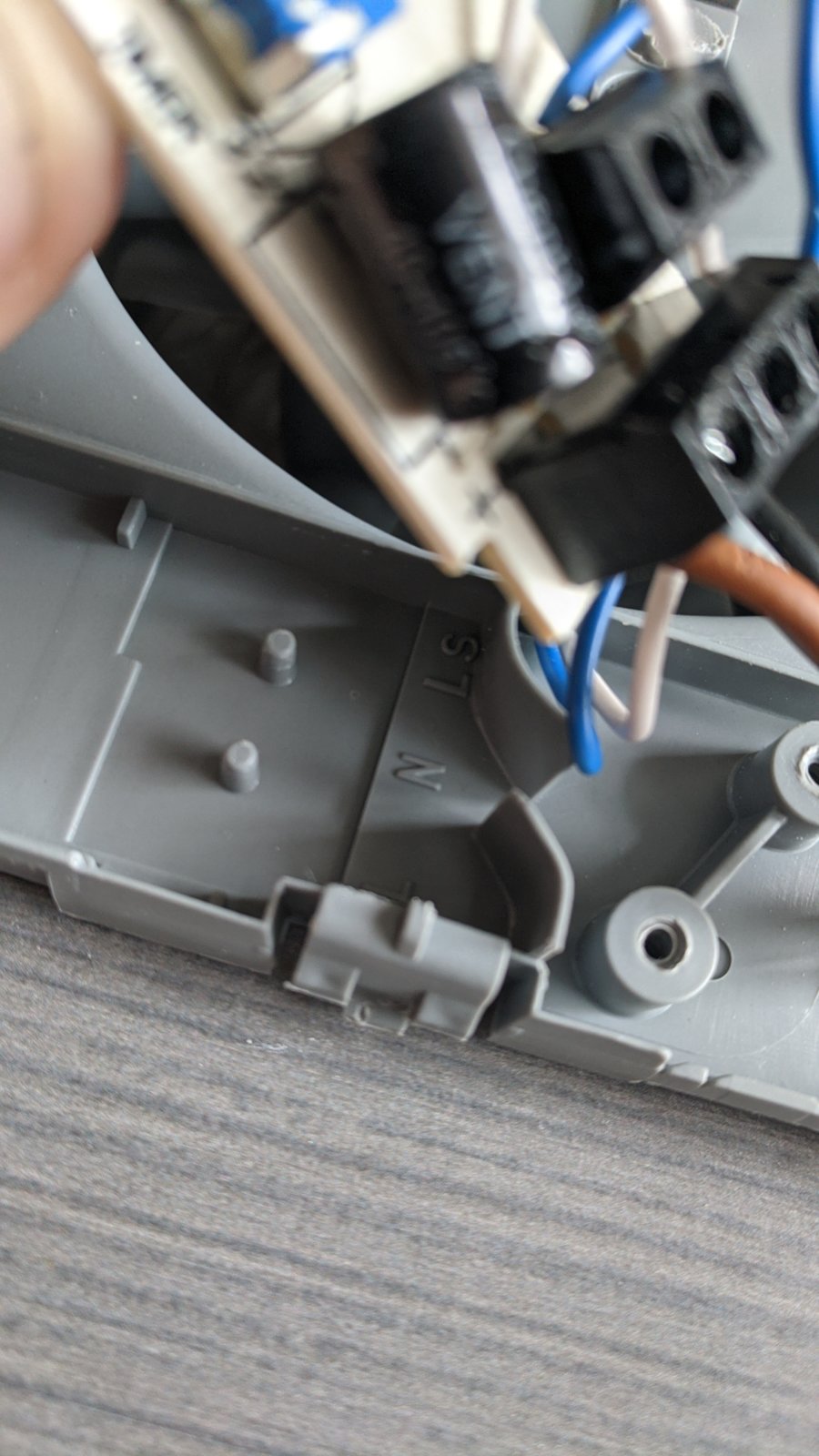

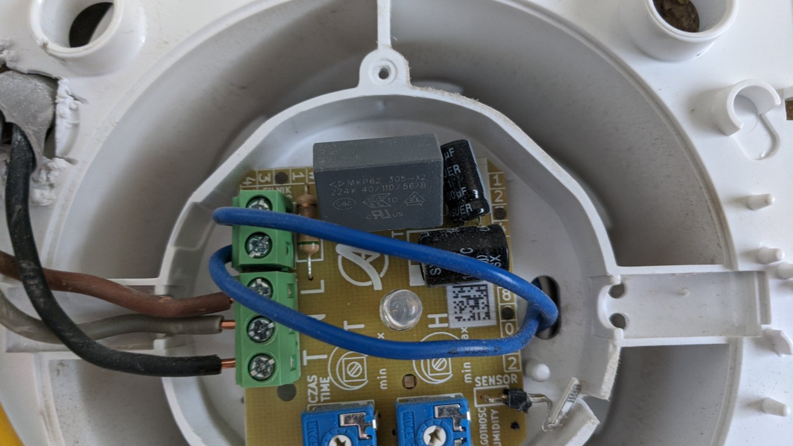

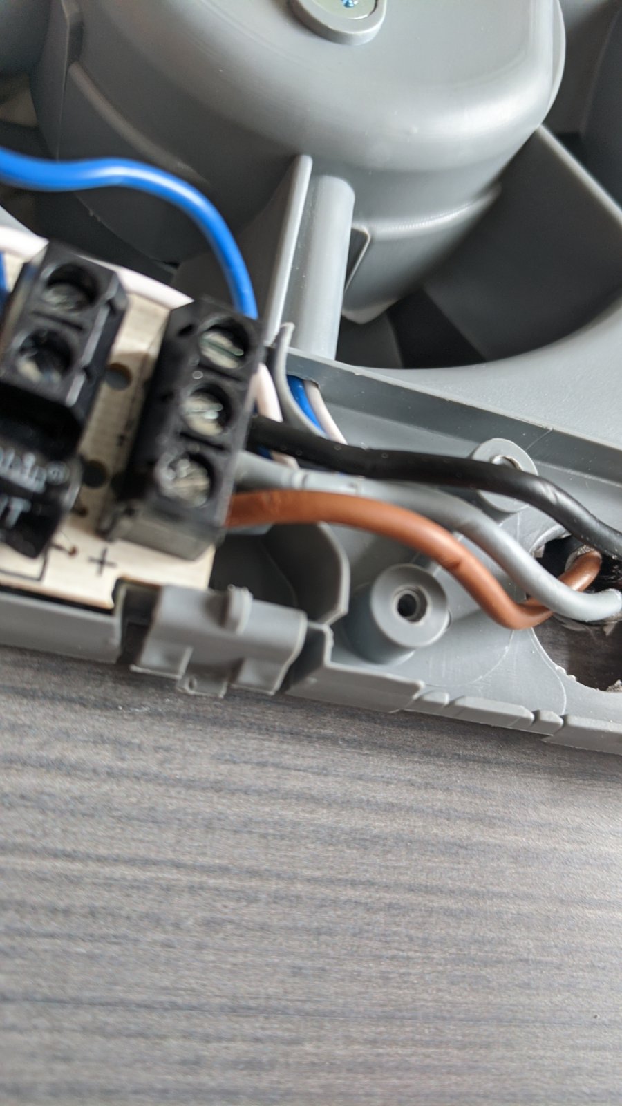

Also you say -
Brown is Live,
Grey is Neutral
Black is Switched Live
But you then said you changed the grey and black the other way around. So you switched N & SL and it came on/off with the light?
Are you able to get a multimeter and confirm which colours are L, SL & N?

Sorry, I meant I changed Brown and Black. Left Neutral how it was.
These are images of the wiring. 1 photo is the old fan before I disconnected it and the 2 are of the new (2nd) one I bought today.
Switch the light off, switch the circuit off at the CU (so the fan stops)
Remove the bulb, then switch on at the CU.
Now switch the light on (fan should start but obviously no light), switch the light off and see if the fan stops after a few minutes.
Excellent! That did the job. Was it the bulb it didn't like?

With the fan running, there is a connection between L and SL of a certain resistance due to the internal circuitry of the fan timer.
With the fan not running, that resistance is either not there, or is sufficiently high that the following effects don't occur.
With the light switch on, both L and SL at the fan are connected to the same 230V. The fan timer is triggered continuously so the fan starts and stays on.
With the light switch off, L is still connected to 230V so the fan keeps running.
What SL is connected to and what happens next depends on the lamp installed:
1. Filament lamp installed:
A tiny current flows from L to SL in the fan, through the low resistance lamp filament and to neutral.
Result - voltage on SL is zero. The timer is not triggered and the fan stops after the preset time has elapsed.
2. No lamp installed:
No current can flow from L to SL, so the voltage on SL depends entirely on the internal resistance of the fan timer between L and SL. The timer is designed so that this is lower than the trigger threshold of the timer, so the fan stops after the preset time has elapsed.
3. CFL that causes the problem installed:
This will have a capacitor inside between L&N (plus various other components)
A tiny current flows from SL and charges the capacitor in the lamp, this causes the voltage on SL to rise gradually.
If the capacitor charge time is less than the time set on the fan, the voltage across the capacitor (and therefore on the fan SL terminal) will rise to a level sufficient to trigger the timer in the fan, which resets the timer and the fan keeps running.
Eventually the capacitor will discharge when the CFL tube conducts, this may be seen as a visible flash in some cases.
The cycle then repeats, with the capacitor charging again and resetting the timer in the fan.
This is related to the problem of certain CFLs flashing intermittently when off, or some LEDs glowing dimly, although in this case it only occurs if the fan has already started as the source of the current is the fan itself.
