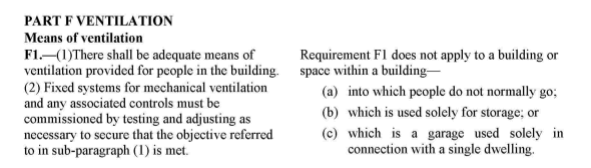

I too was under the impression that bathrooms and toilets needed to have mechanical ventilation if the room had no opening lights.
I understood it was a building regulation. Several building control inspectors I have known had the same understanding.
My dad moved into a brand new house in the 70s, with not a single fan to be seen.
So when was the requirement for a fan introduced? as there were whole developement built in 70's without a single fan in site.
I don't follow your line of thought.
I am saying there never was and is not a requirement.
Bathrooms and toilets need ventilation.
How that's achieved isn't specified.
Opening windows are one common option, as are powered extractors.
A vertical pipe set into the ceiling and exiting into the open air would be another option, convection would provide the airflow.
As is often said with Part P, this is Part F, there is no more...

From post#6 onwards it appears you are contradicting me.
So I'll clarify my understanding of planning rules; adequate ventilation must be provided throughout a dwelling... moreso in rooms with high humidity such as kitchens and bathrooms where exhaust or extraction is required. If there is no opening window or other equivalent ventilation then LABC will expect or instruct a fan to be fitted.

Well I would be if you think fans are compulsory.
Sort of, see Part F above.
It does not say that - just "adequate ventilation for people in the building".
Not quoted from anywhere, just my laymans expectation.
Then they are wrong.
Because Part F (2) mentions mechanical ventilation, I presume some people might think it is compulsory.

Fans are not compulsory. End of.
It is not illegal to allow water vapour or, god forbid, smells to escape from the bathroom.

Correct but at planning and construction stage adequate ventilation is required and if no other form of ventilation is adequate, the LABC will expect to see something like a fan to adequately ventilate the space.
A fan is now spec'd by architect's in a matter of course in the same way as BS7671 is cited for part P but that's a different matter.
For people in the building.
That does make it right.
That does not make it right.
People do and believe all sorts of strange unnecessary things.
Oh it does make it right, or more correctly acceptable, as an adequate means of ventilation. Just because it is not compulsary in the situation, using a fan isn't wrong. Just as using a fan in a heatwave to create a draught is not wrong although there are other acceptable, and possibly more effective or efficient, methods of keeping cool.
