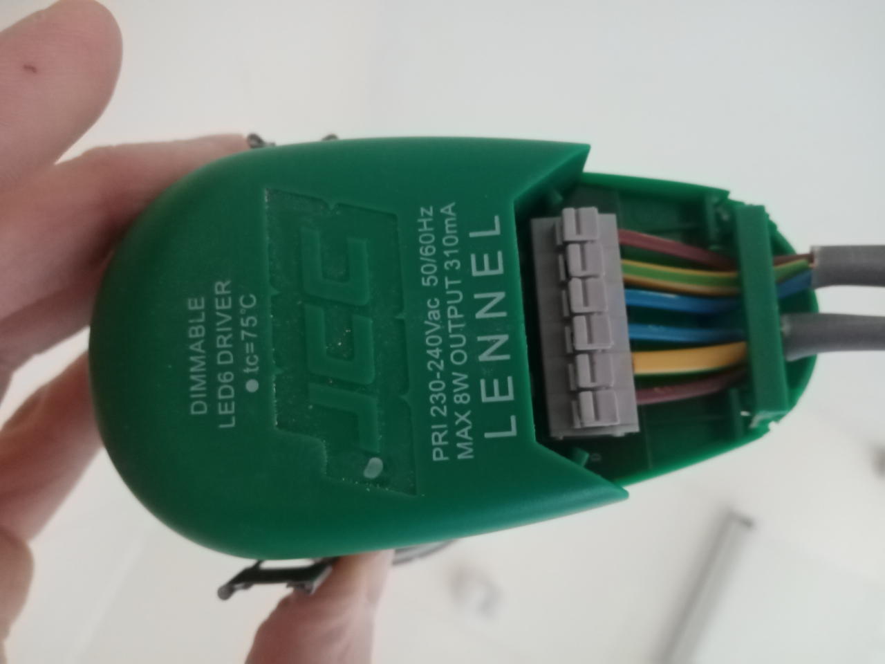

Thanks. When wiring up is there a particular In and Out or does it not matter?

In most cases it’s really straight forward.
The JCC and the KSR both use push fit connections. Just make sure you connect them correctly as shown on the units

From what I can see on the JCC with wires in place, there doesn't appear to be an in and an out.
Turn off circuit and push the grey tabs down and pull the cable out of the fitting
