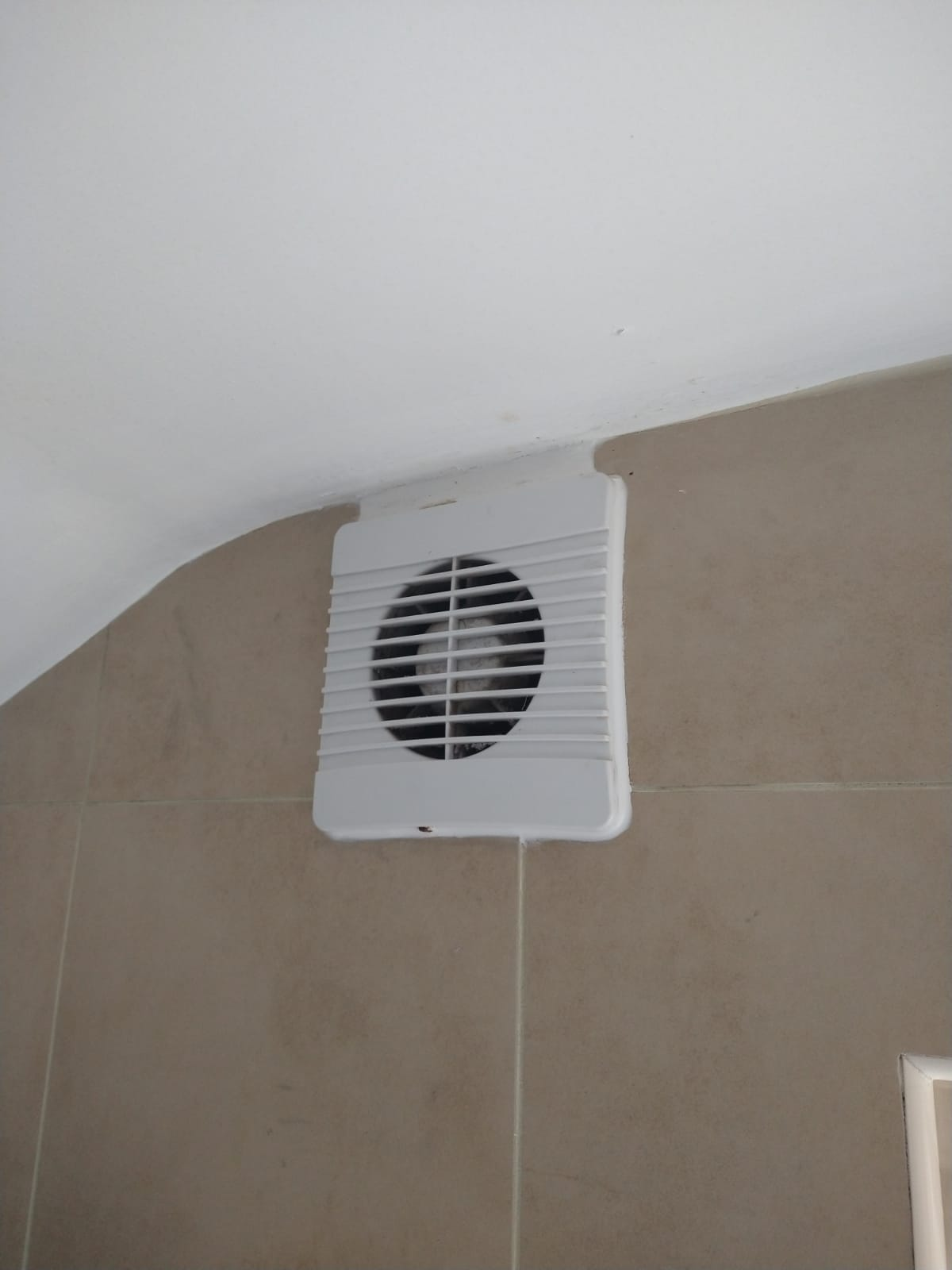

I have a series of bathroom ceiling lights which are controlled on/off via a simple pull cord switch (10A). The extractor fan is also controlled via the same pull switch with no timer, so lights on/off and extractor on/off are together.
I would like to be able to isolate the bathroom fan separate to the lights as it is very noisy on a night or sometimes when you want to have a bath.
The existing lighting circuit is on an old wiring system, and there is no earth present on the pull cord switch housing, just the standard red/black into COM/L1. The extractor appears to come off a junction box from the lighting circuit but I haven't looked at it in detail.
Would it be a real pain in the arse to create a separate switch to isolate the fan? An electrician friend of mine said you could just add another pull cord switch for the fan, but I'm guessing it may be invasive work into the ceiling. For the record, I can't get "above" the ceiling in question.
It's highly unlikely you could alter the wiring without access to it !!
I can pull the junction box which feeds to the extractor fan through the hole for the ceiling light.
Likewise can pull plenty of cable through from the existing pull switch and have access via four ceiling hole lights, so could trace some cable back to a separate pull switch fairly easily.
What I meant was I can't climb above into a loft like I can for the bedroom lighting circuits.
Sounds like you may be able to do it without too much hassle. What conductors are present at the JB ?

Please post a photo of your old fan.

Perhaps you just need a new fan? Some have two voltage settings, on the more quiet setting, less air will be extracted per minute though.

Presumably, it might me not seeing the forest for the trees, at first a new fan seemed a lot more work, but in hindsight it may be a wiser option.
I think it might be an Xpelair VX100
The Silent 100 range by Envirovent/Soler & Palau is much better
