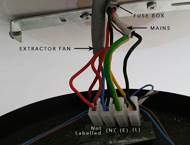

I've recently moved into a new house to find the extractor in our bathroom not working. In addition, the 3-bulb halogen light fixture has now given up so I was planning on replacing with a couple of LED spots and fixing the extractor at the same time.
Taking the halogen fixture out, it seems the wiring is a little more intricate than I was hoping! Now contemplating just replacing the fixture like for like but thought I'd post here first for your advice, tips and comments on the current wiring, as per my image below...

Not labelled - Line(live) input, Line to switch and Permanent Line to Fan. The unconnected wire is presumably why it isn't working.
(N) - correct Neutral.
(E) - correct Earth.
(L) - Black Switched line and Yellow Switched line to fan
Thanks so much for your replies! So the wiring at the fixture looks correct?
You're probably already aware but the 2nd image is the fuse in the adjacent cupboard, not the actual light switch.
I'm almost certain it's the 2nd grey cable that enters the ceiling - it runs in that direction of the cupboard from the the light fixture.
