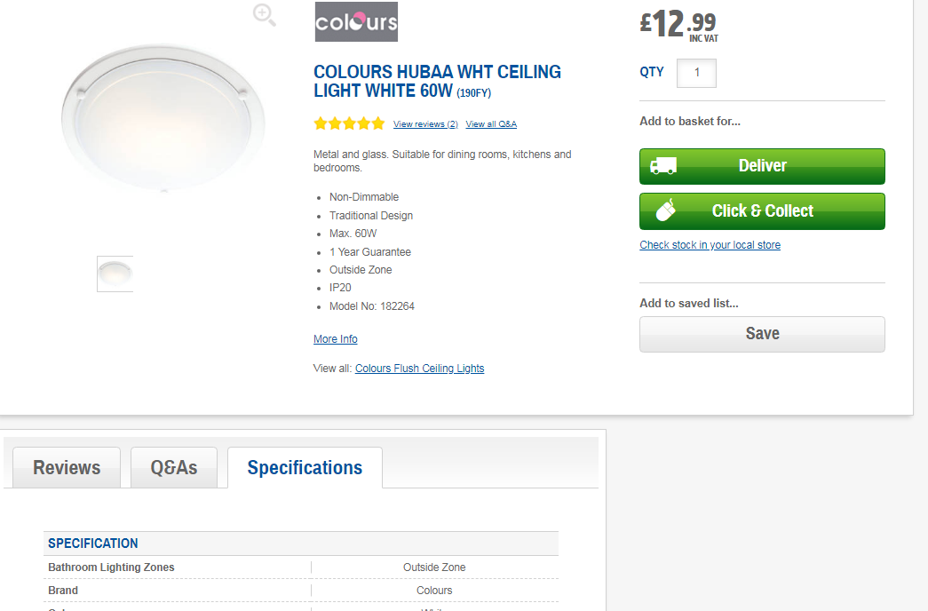

This is the light the lady would like as its the same from her previous house.
I see it reads Outside Zine IP20 which i think means not bathroom ?
The light in her bathroom isnt directly over the bath etc so can you advise what the Outside Zone Ip20 is relating to.

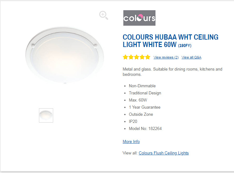

It means higher than 2.25m from the floor level or more then 600mm. from a vertical line from the edge of the bath or shower.

I have looked at the More Info as are you talking about Outside Zone ?
Also in your link i see part number 643 where this one is 190
