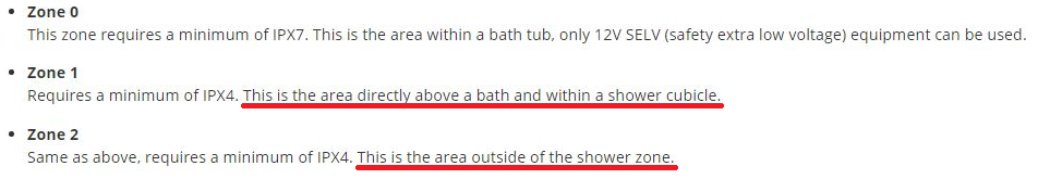

I would like to put standard pendant light fittings in my bathroom...
is this OK??
Russ
Yes.
However, the bulb should be >2.25m above the floor OR 600mm. from a vertical line at the edge of the bath or shower.
I like these, you may not.
That link is not particularly helpful - nor correct.
Underlined not really correct.
There is no zone associated with a basin.
The OP wants to fit a pendant so my advice is all he needs to consider.

As someone else mentioned, check the 'zones' before doing anything.
