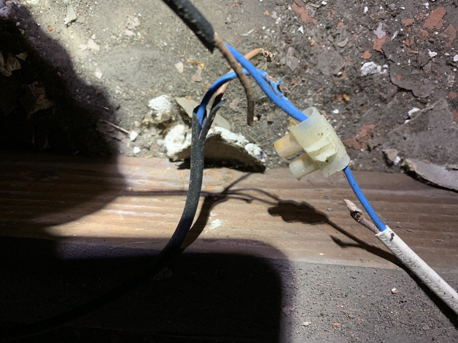

Hi
We suddenly found that the three bulbs on the right hand side of bathroom ceiling weren’t working yesterday. Got up today and same issue. Happy to replace bulbs, but is it more likely to be an issue with the unit in the loft that provides power for the bulbs?
(Had the bulbs for years. V occasionally all lights would dim, but then restore later. Never had this issue before!

I recently looked at a similar issue for a customer. When I got into his loft I found the cables supplying some of the mains powered spot lights had been completely severed, most likely by a squirrel. No transformers in this case. One terminal block was missing, teeth marks were obvious on the remaining severed cables. You may want take an initial visual check in the loft to see what arrangement you have and that it is all intact before any further steps.

Hi
Just been up in loft. I’d forgotten (lights installed by spark years ago) how little space there is to work in the loft. I’d also fitted those things that look like inverted plant pots over the lights to stop them overheating and allow you to lay insulation over them etc.
It would be a hell of a lot easier if I could do all the connections from below. I’ll obviously turn power off and check how halogens are connected, but is it likely they are connected to separate transformers or a single one, with junction boxes etc?
Thanks again
Could be one, two or even 6 transformers.
Doesn't really matter - old lights and transformers disposed of, you just need to find the 230V supply cable and pass it through the nearest hole in the ceiling.
Connects to the first light, then additional cable from that to each other light in turn.
