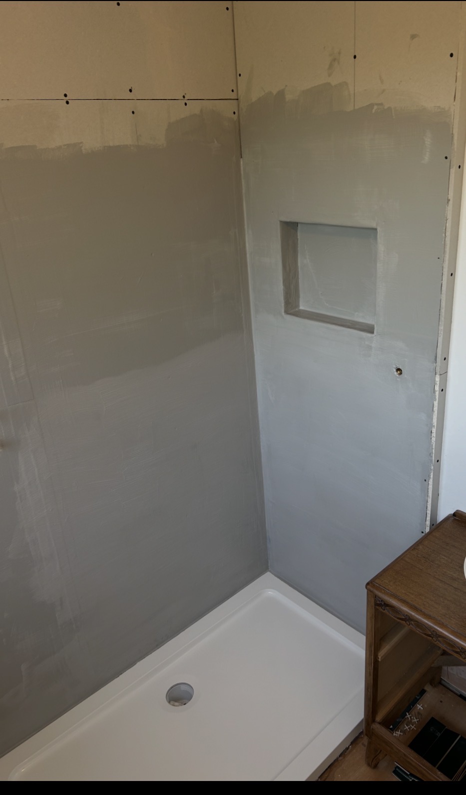

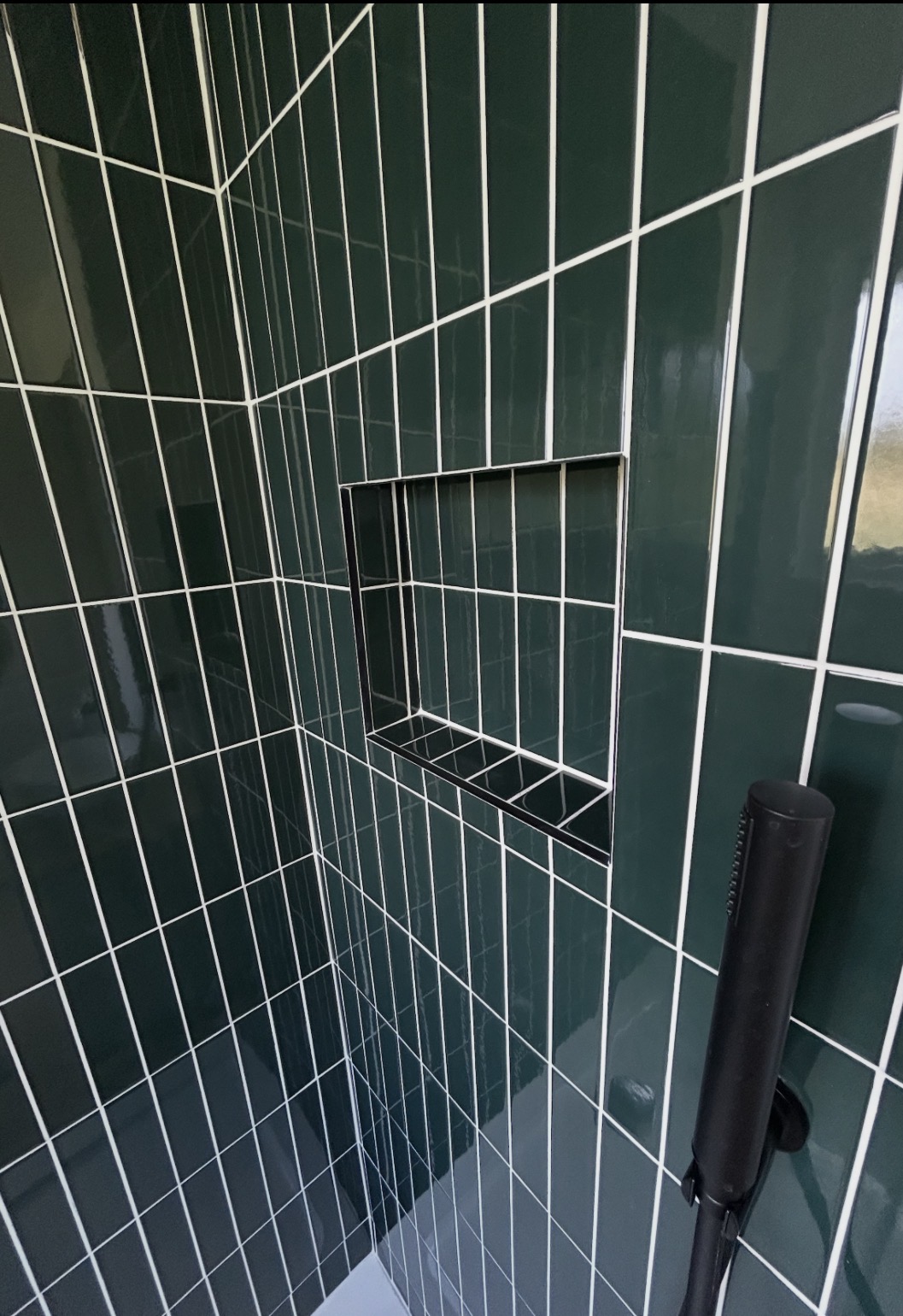

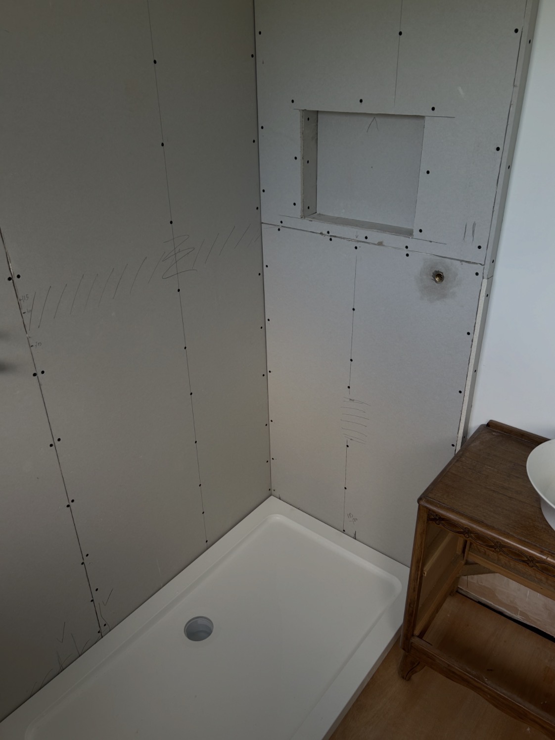

I did one last year, normal plasterboard then tanked. Came out nicely
