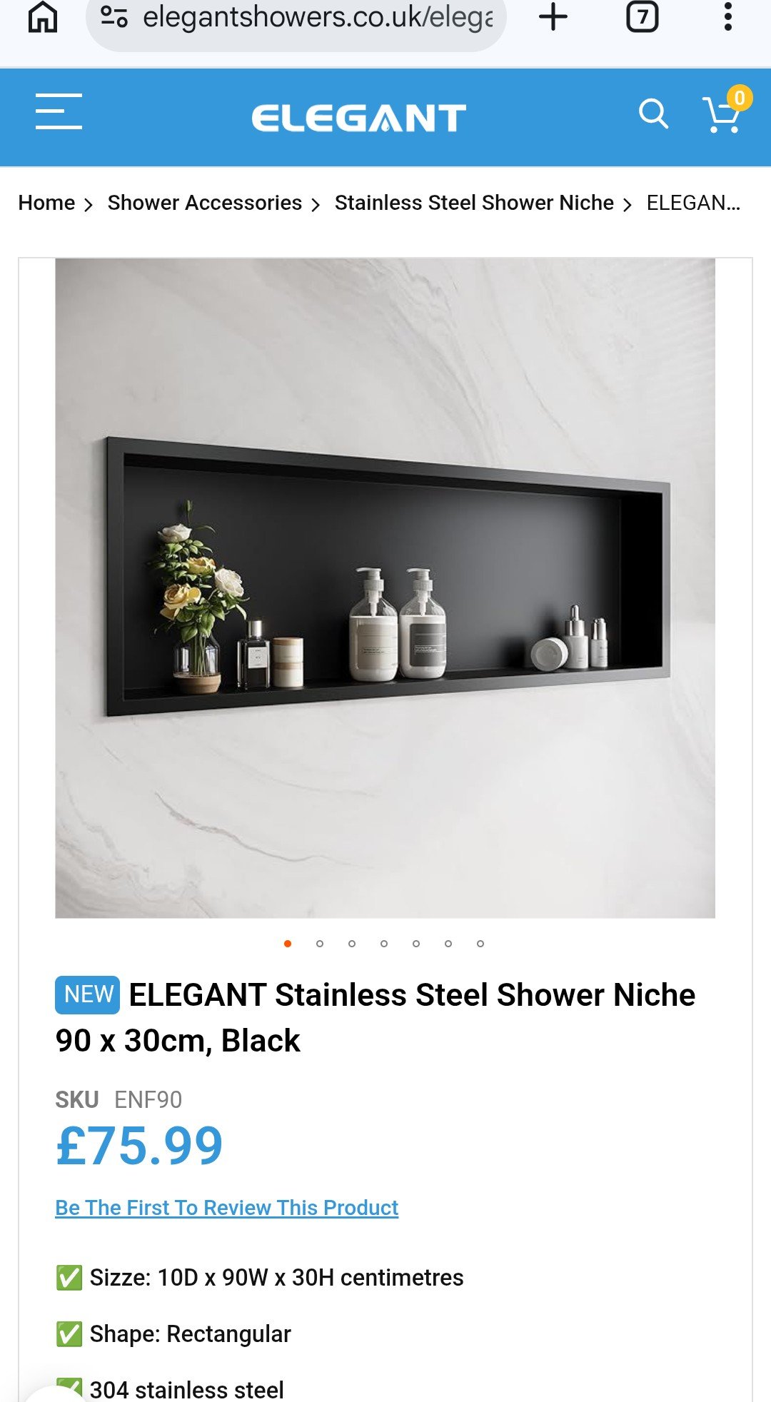

You can buy numerous performed niches.

Pre-formed would be fine, that would deal with all the waterproofing issues.
Just as long as it's proud of the surface as shown above, not recessed in with tiles over its faces - then you have a joint that's just asking to become a new drain.
Having said that, its top edge is a potential leak and/or slime trap.

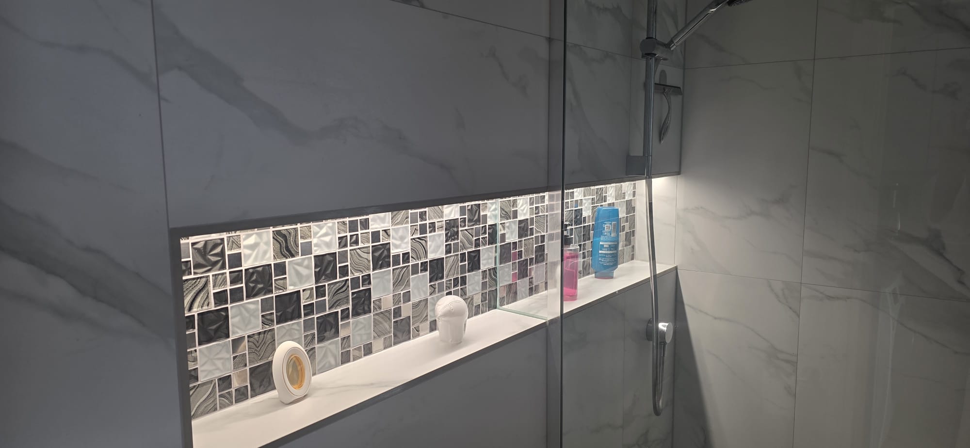

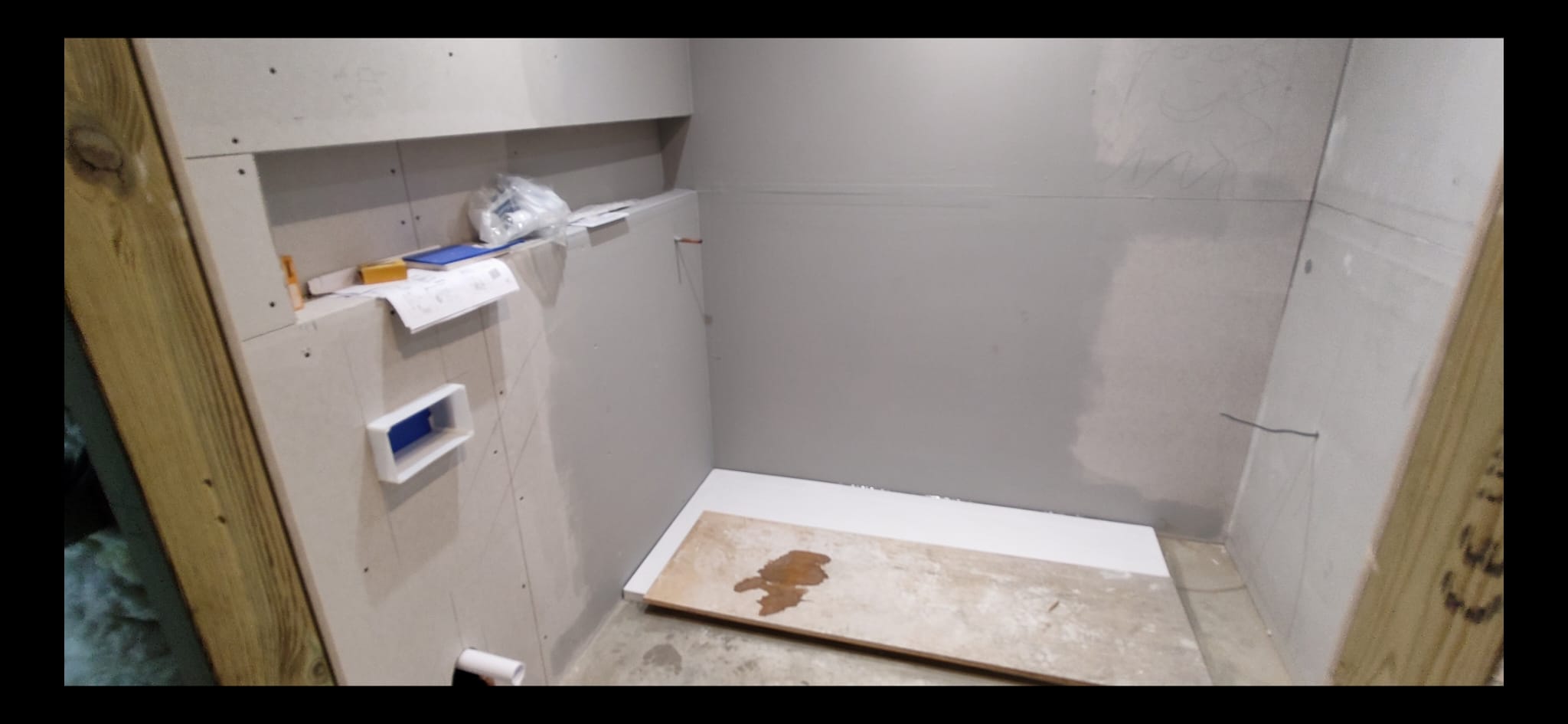

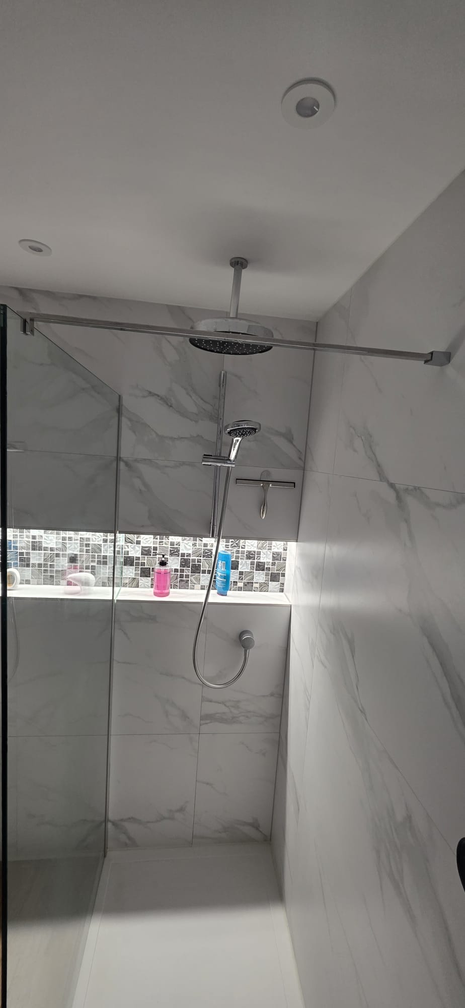

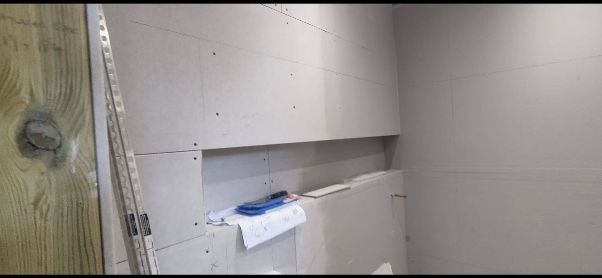

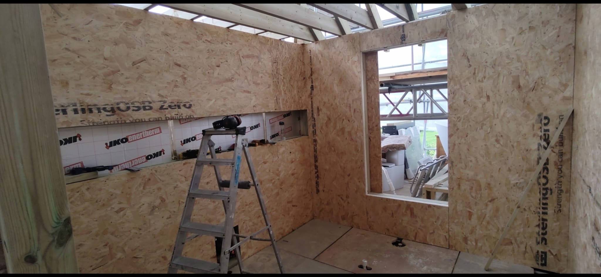

I have shower niches in both bathrooms. I wanted a niche and my builder suggested full length niches to avoid cut corners in the shower. They are much easir to fit but should be an integral part of the build. You need to plan for the drainage, electrics and the shower rail positioning
I have some work-in-progress pictures below

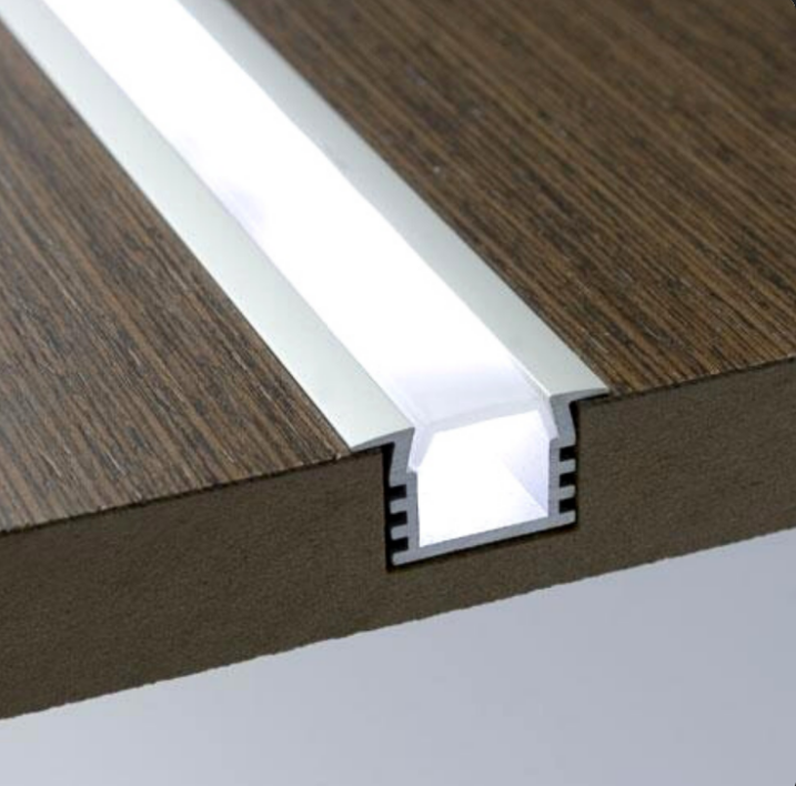

I bought the "winged" LED profile (pic below) and had the tiles cut to leave a channel. These lights are controlled by an IR sensor and I used a CCT LED and then set the colour to the right temperature and brightness to be suitable for nighttime
Regards
Tet

Looks great

Is that plasterboard?
