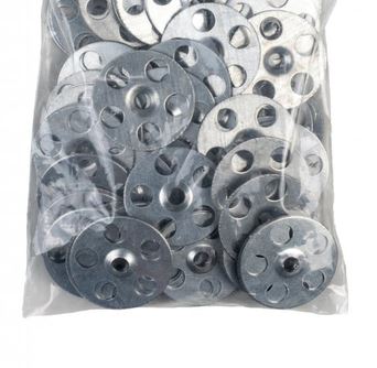

Use the disc washer that the mi's recommend,and as above,support horizontal baton with vertical ones.

Thanks, yes I plan to use those washers. So just to clarify so I know I have understood correctly...

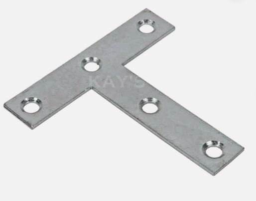

You could use these to secure the horizontal to the verticals.and as above use an adhesive.
