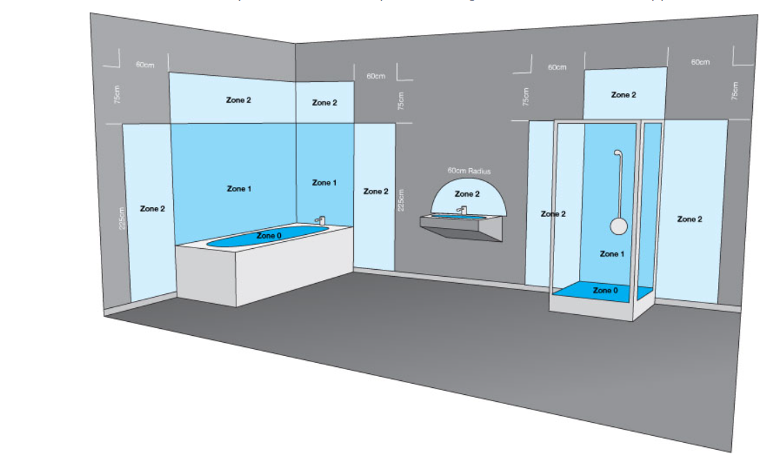

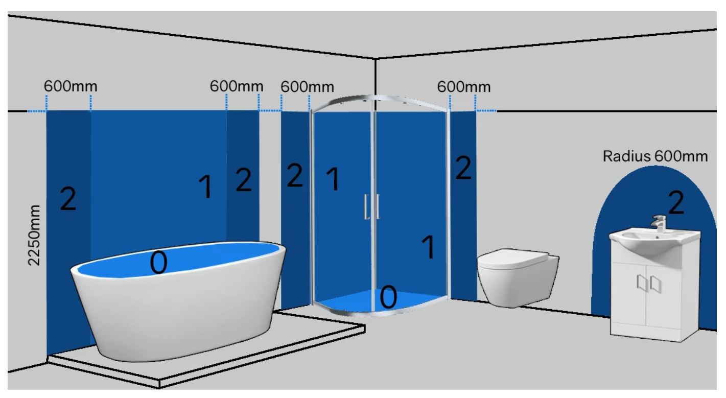

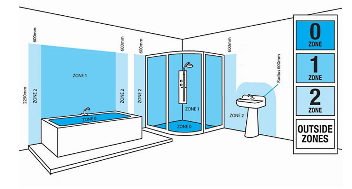

Does anyone know why virtually all zone diagrams on the web are wrong and show a zone round the washbasin? Even well known suppliers seem to get it wrong.
I am finding plenty of online sources stating it is 'best practice', or 'advisable' for the area around a basin to be treated as zone 2, and then include that in the diagrams as de facto.
Interesting point here:
https://www.voltimum.co.uk/articles/q-day-zone-2-above-hand-wash-basin
I believe the argument from the NICEIC is, that a wash hand basin doesn't have to be considered as a special location.
However, regs 512.2.1 & 2, suggest electrical items should be appropriate for their location.
This (theoretically) draws a radius around the basin where any items within, should probably be rated at IPX4, or better.
In effect, the area is a zone 2, even if it is not named as such! :)
...but that's only my interpretation! ;)

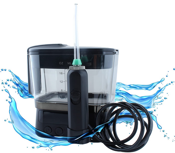

The bathroom has a new piece of equipment, not that I use it, I have no teeth, upload_2022-3-21_6-31-16.png the units use more than a shaver socket can provide, and are clearly bathroom equipment, in the main in UK we use rechargeable versions to get around lack of supply in a bathroom, the water flosser is mains powered out of the UK, so maybe our rules will have to change?

Someone I spoke to at the IEE suggested that the lighting manufacturers clubbed together and decided to promote the faux sink zone as a way to sell more expensive light fittings.
The Zone 2s around the shower cubicles are not correct either so shall we just put it all down to the diagrams being drawn by people who do not know what they are doing?
Yes. Or they have just copied the version that they have always used, but removed zone 3.
The correct diagram is here.
https://electrical.theiet.org/media/1450/section-701.pdf
Surprised that the OP hasn’t mentioned that manufacturers instructions are usually wrong. But I expect that he/she will before too long.
Most likely it originated with the attached document, which was information provided to ILA members (who are mostly lighting manufacturers) regarding bathrooms, and contains the 'LIA IPX4 Area' which was subsequently copied by others, assumed to be part of BS7671 and misappropriated into the mess of diagrams available today.
