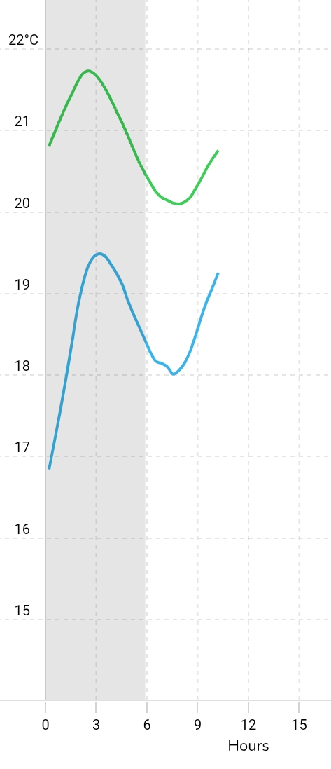

I note the report on room temperature. 1743243862679.png It shows living room top, which gets the sun, and wife's bedroom bottom, which gets very little sun. More interested in the speed at which temperature drops, 19.5ºC to 18ºC from 3 am to 7:30 am, around 1/3 of a degree per hour.
So 8 hours sleep, and drop around 2.5ºC. So setting a thermostat 20ºC in the day and 16ºC overnight, only with very cold nights would the central heating cut in.
Bedroom heated reasonably fast at 1ºC per hour, but living room, at 0.5ºC an hour, need to start heating way before we want the room.
The problem is likely the TRV heads had not opened the valve fully, I know we should control the room with TRV heads, but if I want living room at 20ºC I tend to set TRV heads to 22ºC and let the wall thermostat control the room.
