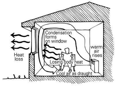

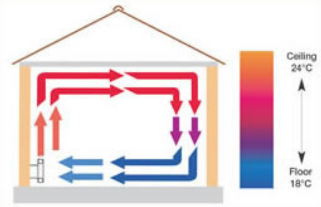

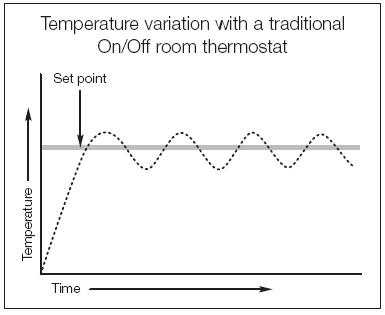

Clearly the hotter the home, the more fuel used, I am not talking about that, what I am talking about in the main, is the latent heat extracted from flue gases, and the effect of sine wave temperature control. Temp_variation_on_off.jpgTemp_variation_TPI.jpgTemp_variation_OpenTherm.jpg We have been shown the diagrams for years, also the circulation diagrams circulation.jpgcirculation2.jpgand the argument as to where the radiator and the thermostats should be placed. And I know due to getting it wrong, it does matter, but the theory can't always be done in practice, putting the radiator against an internal wall reduces losses through the wall, but then one is left with any wall thermostat being on an outside wall.
The whole idea of the TRV seems great, but with modern electronic TRV heads, we see the temperature it sees, which are often much lower to what a wall thermostat sees. Double-glazed windows now have larger gaps, and are much improved, we add loft insulation, cavity wall insulation, and the home it nothing like it was when built, and central heating installed.
Boilers have been changed, often in the case of gas to a modulating type to help extract latent heat, then fitted with a thermostat using mark/space control completely upsetting the control built into the boiler.

The bimetallic thermostat with neutral not connected is likely ideal in a one room home. The 1.5°C between on/off actually helps, so boiler not turned on for a few minutes.
