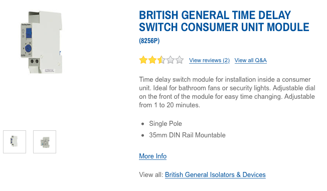

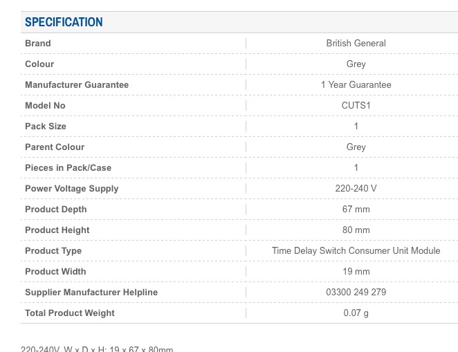

What's the part number of the timer?
Post a photo of the data sheet if you can, it's all a bit guessworky otherwise.
I used this as on the reviews someone had already used and said it worked fine
