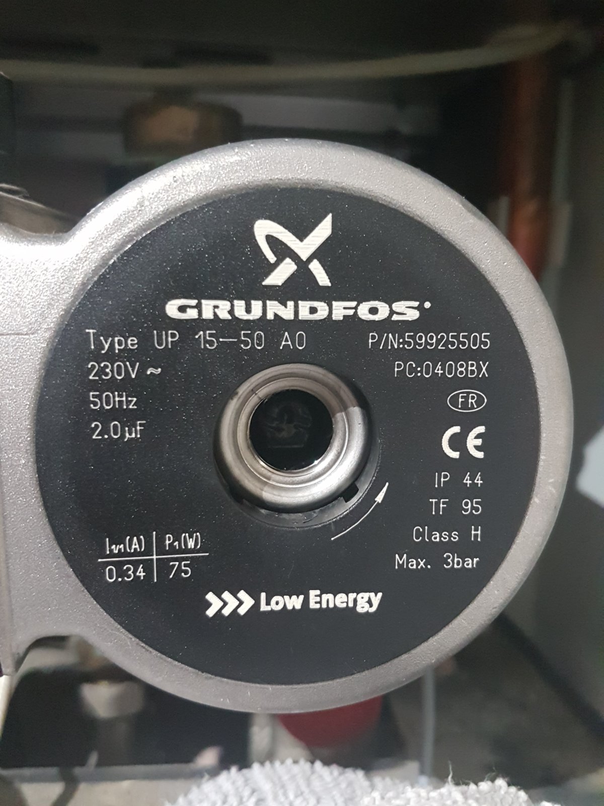

My back combi 80e will no longer ignite a flame. The flame failure light does not come either. I have tried resetting it with no luck. I tried to find a small button the internal pipe on the overheat stat.. but could not find it. I could see the overheat thermostat on the pipe but no little button.
The pressure on the boiler is fine. The only thing I noticed was that the pump felt hot.
Any ideas how I get the flame back on?
Thanks in advance guy.
if the pump is hot it may well be stuck, with a demand for heat remove the large slotted screw from the front of the pump head ( a small amount of water will come out so place a towel below it) the using a screwdriver feel if the shaft is spinning if its not, try and jolt it free by spinning it with the screwdriver, if it frees off replace the large screw and it should fire the boiler, if it doesnt start spinning sounds like you need a replacement pump head.

I tried taking the screw off and there is a screw another black screw behind it.. I tried turning it with a screwdriver but no movement
The pump just gets hot.

Thank You, it is better to change the whole pump or just the pump head... as i can see that i can get the whole pump or just the pump head?
Thanks again all
I changed the whole pump unit but no success, I can hear the pump spinning but no flame on ☹
I can hear it spinning/whirling when i put the hot water on.. but again no flame. It is the same when i put the heating on.
