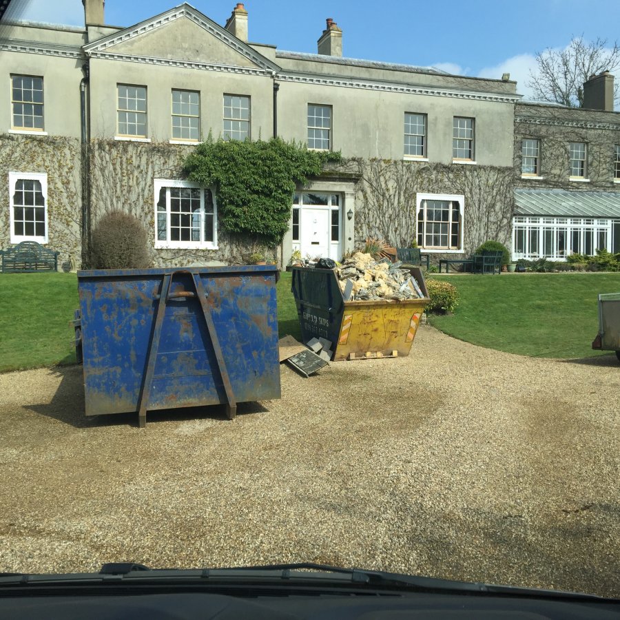

    This is a 7 bedroom house....guess I should of gone for a combi instead of 3 65kw boilers.
    It just gets worse..jeez..:rolleyes:
